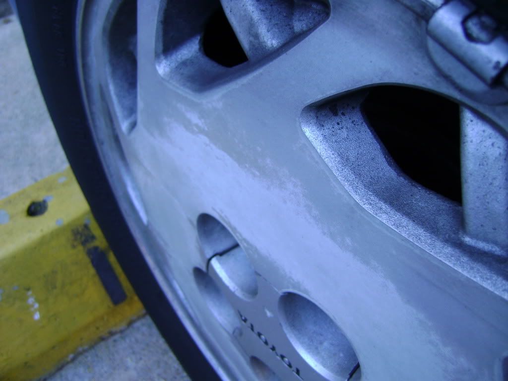

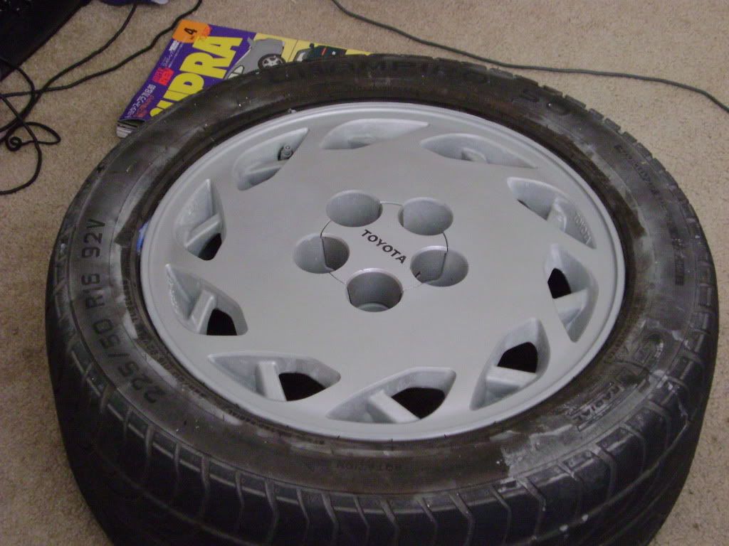

to each his own i happen to like them when they are in good condition as for the pitting what looks like pitting isnt, i need to buy some self etching primer then my wheels will be green for a short period muahahha

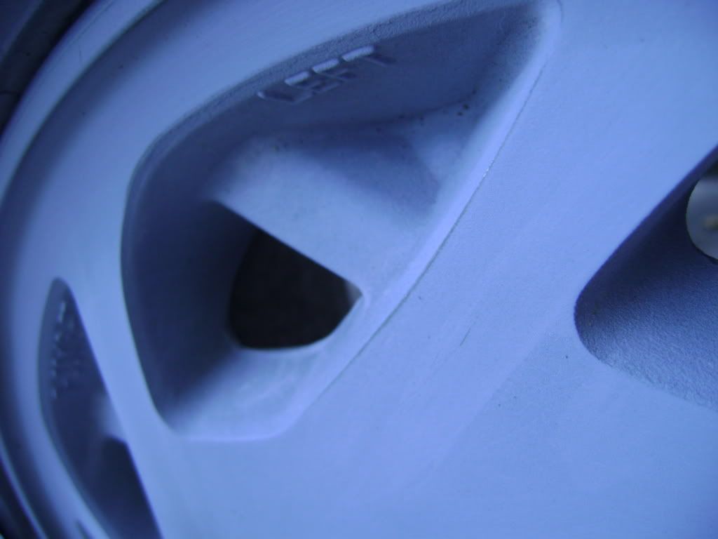

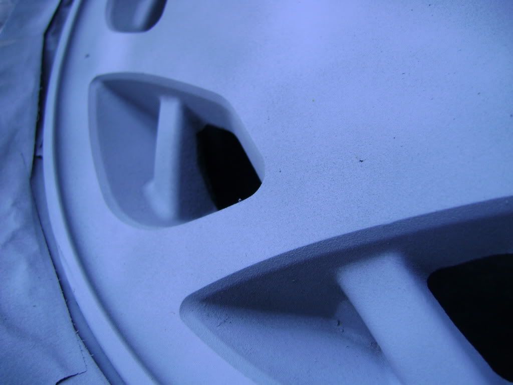

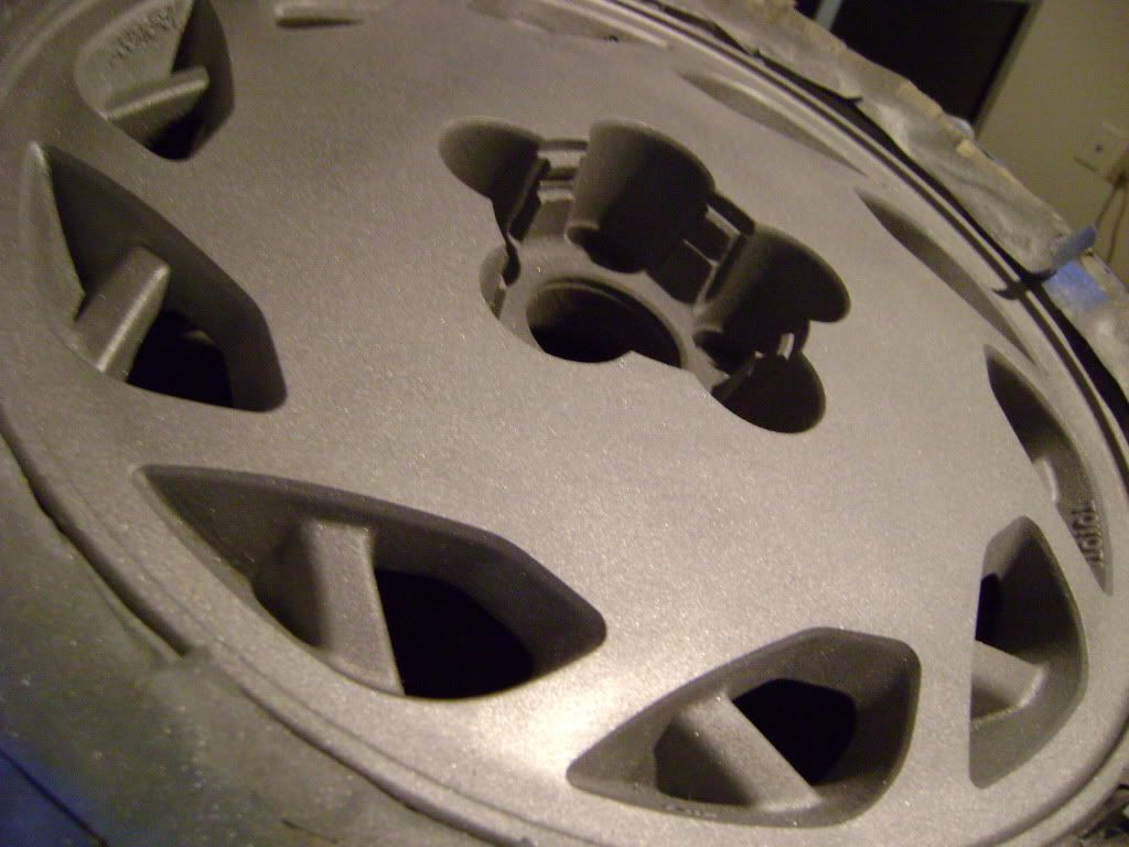

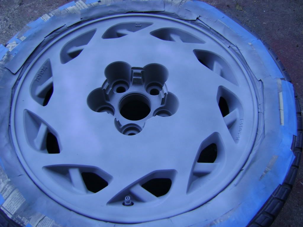

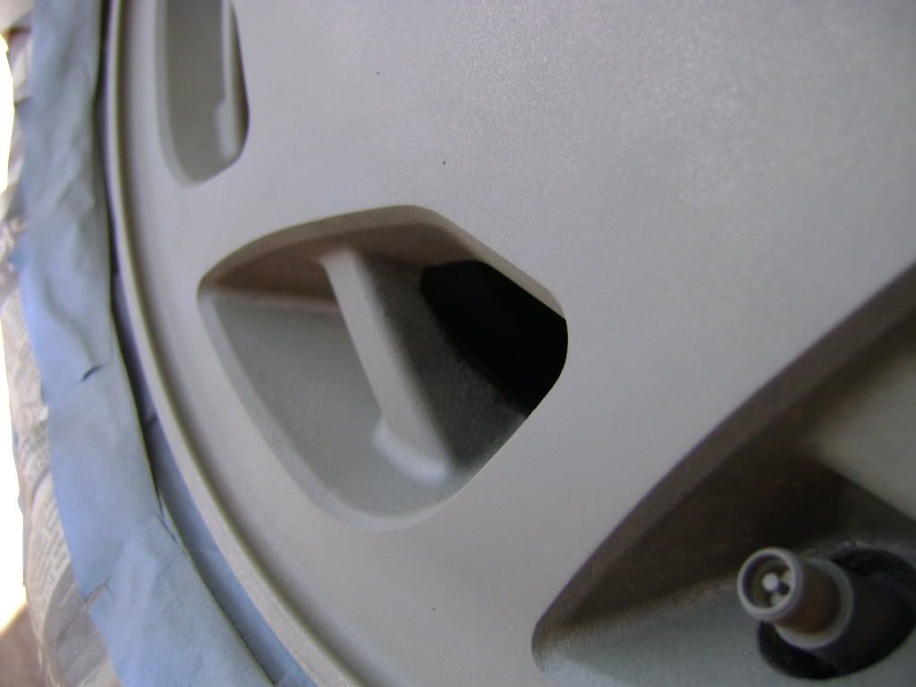

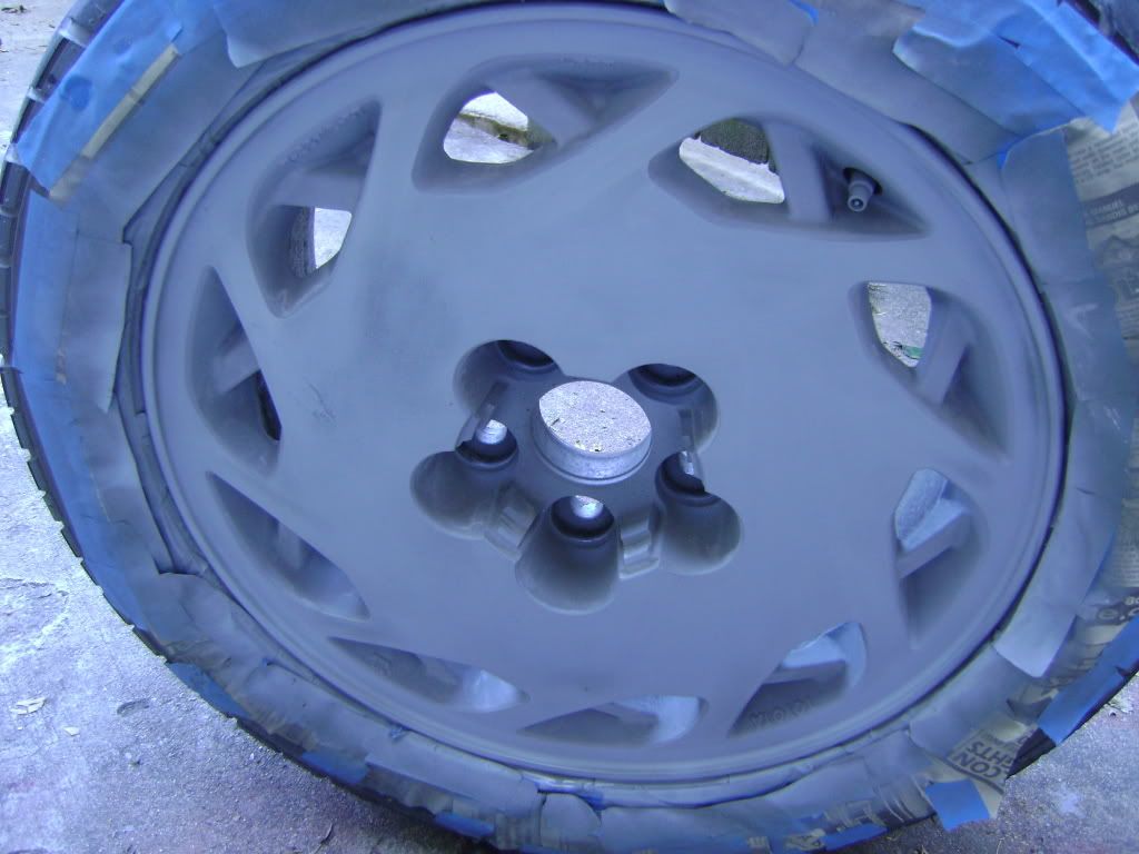

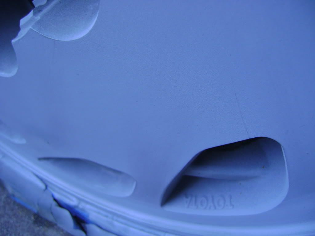

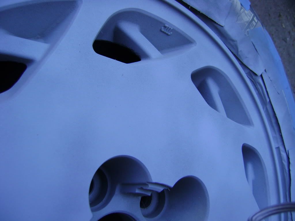

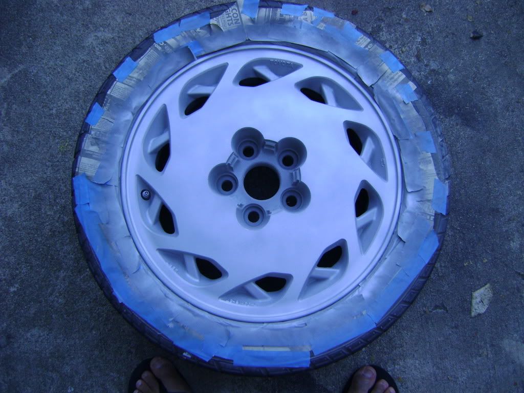

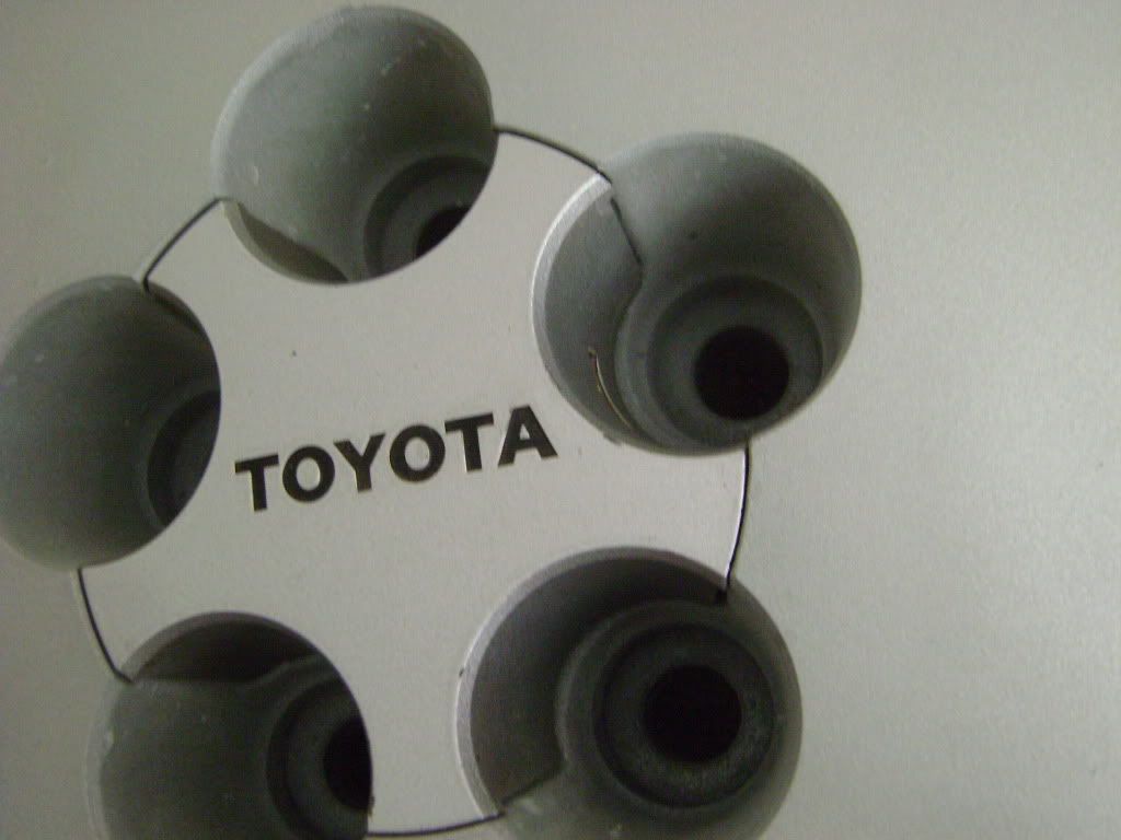

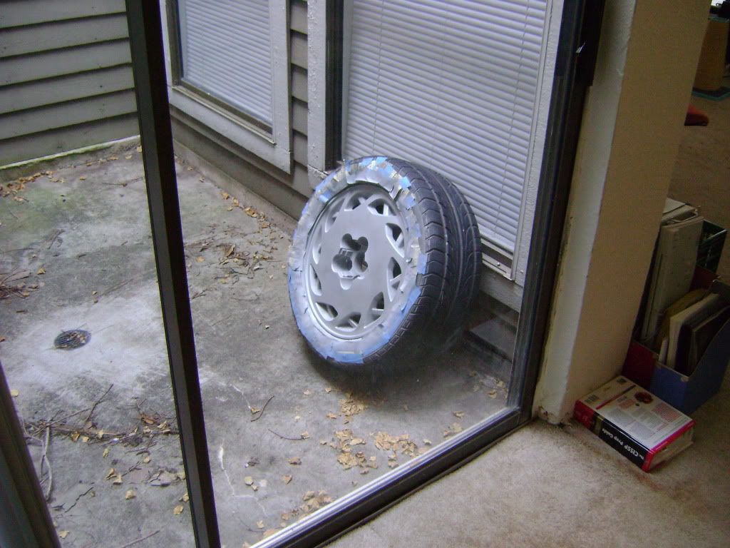

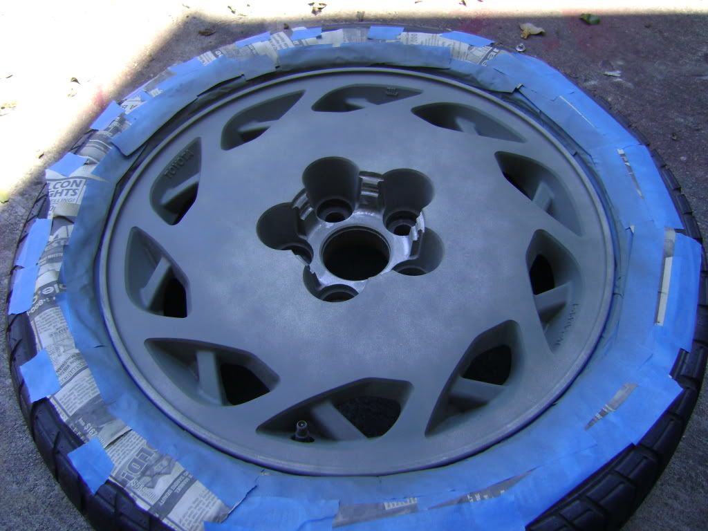

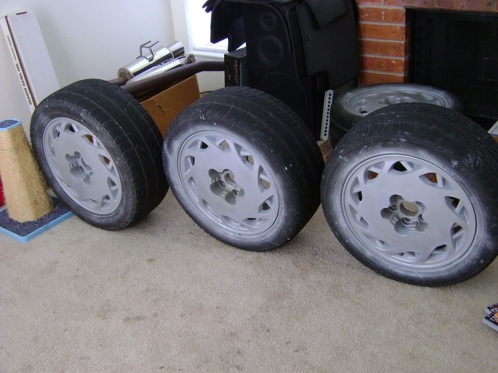

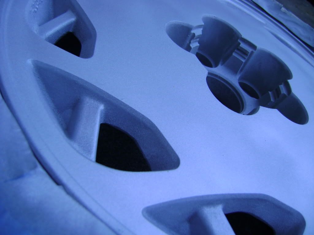

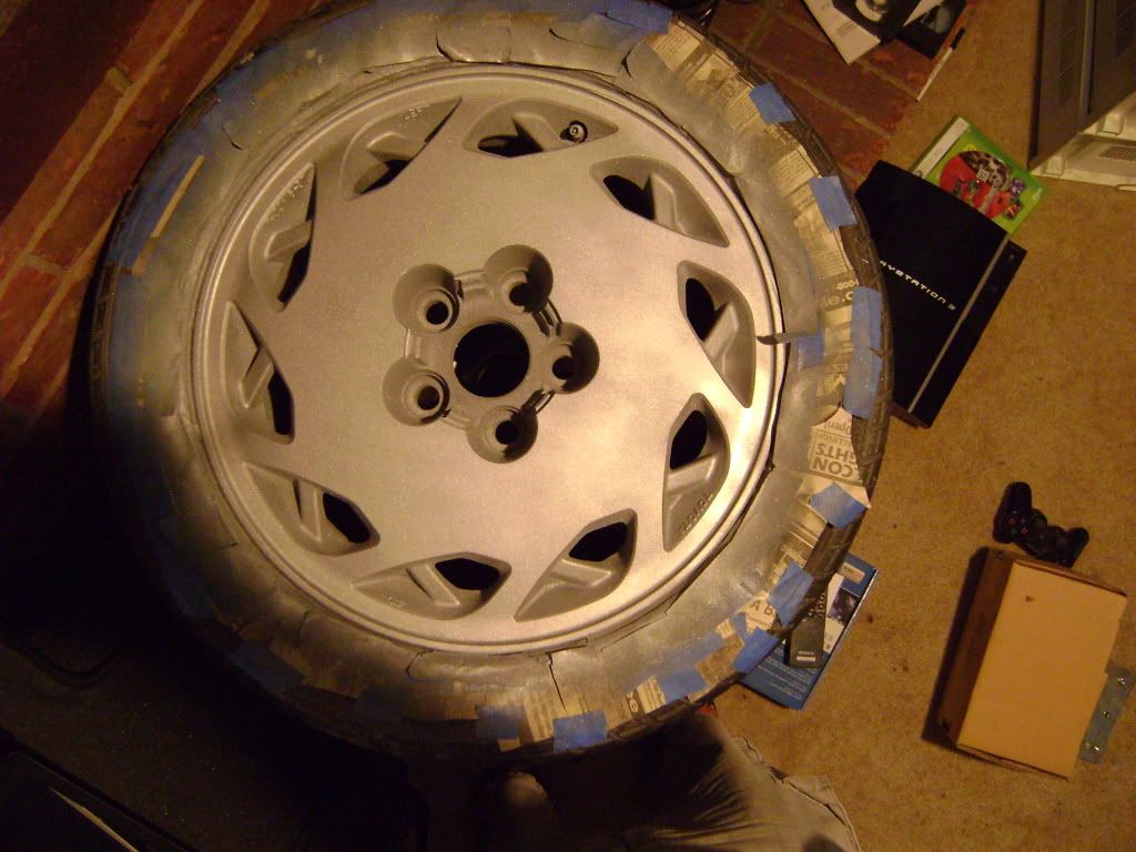

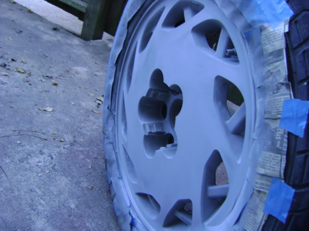

few coats of self etching primer
Olive Drab Wheels
Regular Fillter Primer now a few coats.
Next step wetsanding with 650grit
[ Post merged on May 28 2009, 02:10 PM ]
after wetsanding
this ones ready for paint
Ignore the pollen
[ Post merged on May 28 2009, 05:31 PM ]
Paint On now just need to wet sand and clear

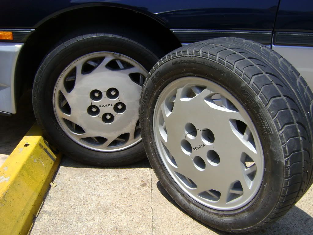

Comparison my old wheel on my car
Under the light
Keep watching
This post has been edited by JDMMA70 on May 28 2009, 02:13 PM

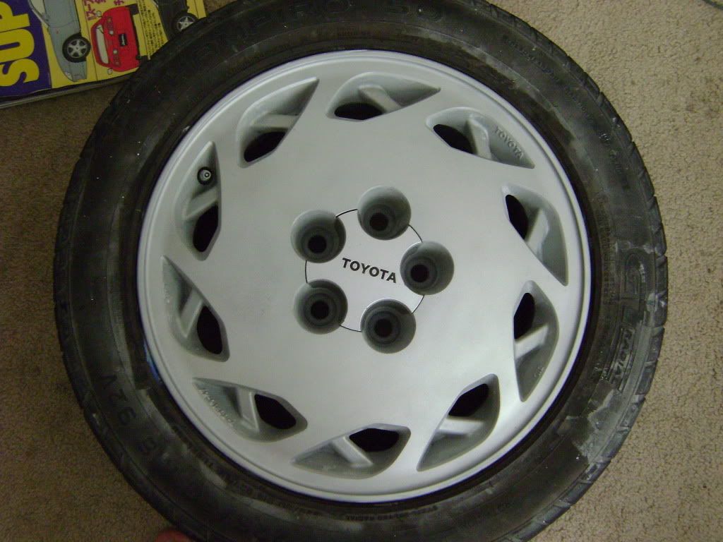

Duplicolor Wheel Paint

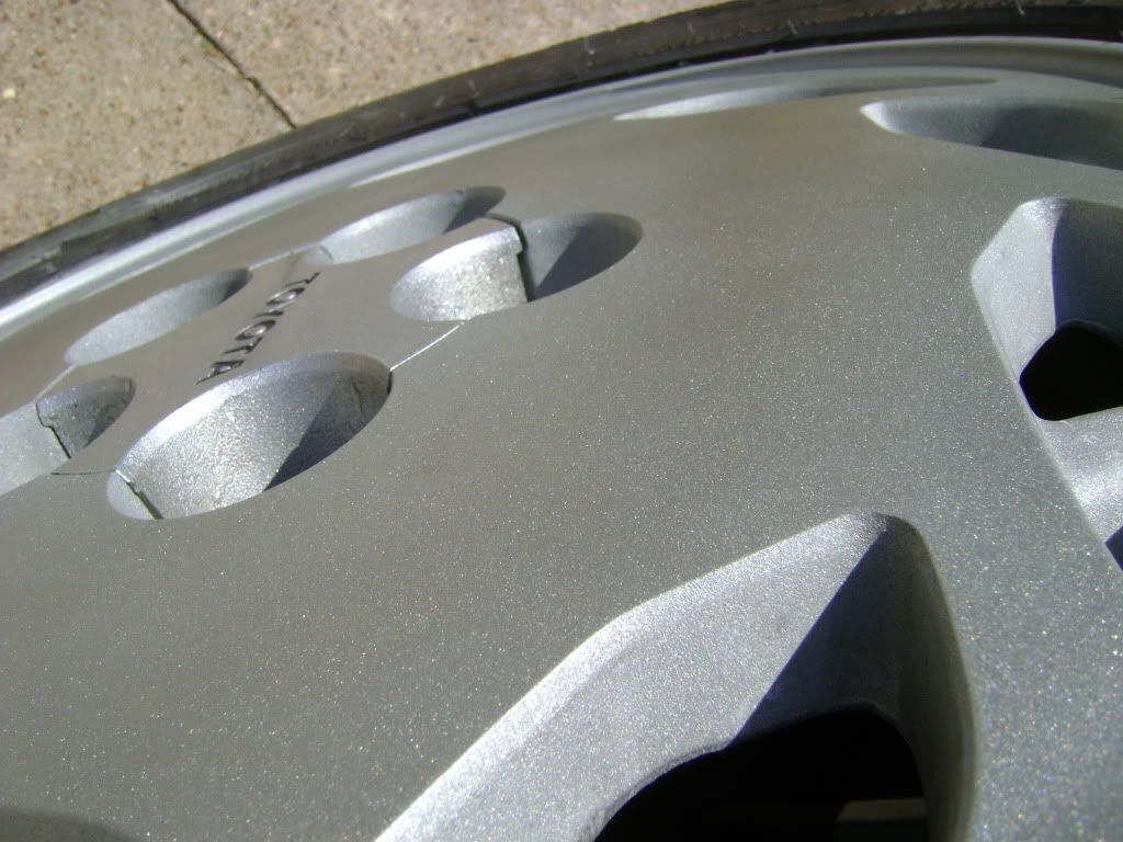

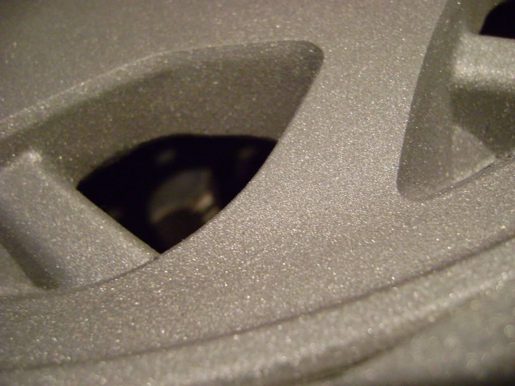

Wheels are finished here are pics there are some minor mistakes but you cant really see them unless you look for them.
Went to check on it this morning was still drying
Wetsanding the clear coat 3500grit essentially done here
How close they match it may look off in this pic but the later pics show the difference
Tell me what you guys think
Posted: May 29 2009, 12:16 PM
Nice. It seems to match up pretty well.

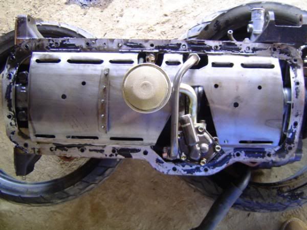

finishing up the three other wheels as we speak. I have no aquired a job and my project is rolling foward again. On my list now is to baffle my stock oil pan maybe also make it bigger with some buldge add ons, and get a crank scraper. I thought about a windage tray to but cant decide both will be good but a windage tray is going to take some time to make. I may just go with a crank scraper (similar concept).
I found this picture of a 7M that was used on the Wangan pretty impressive if you ask me. Not only is it equiped with a windage tray but they also installed a high flowing oil pipe.
gttwinturbo
Posted: Jun 12 2009, 08:17 PM
Posts: 49
Member No.: 3,712
Joined: Sep 27th 2008
Location: Auckland,New Zealand
Why are you going to baffle the oil pan? planning on hard track use?

QUOTE (gttwinturbo @ 2 minutes, 23 seconds ago)
Improvement and the Stock oil pan could use it for hard acceleration and yes it will see the track on occasion.
Posted: Jun 13 2009, 10:52 AM
I <3 my oil pan baffle! When Summit Point or VIR (Or Autocross calls) I find it very nessecary!

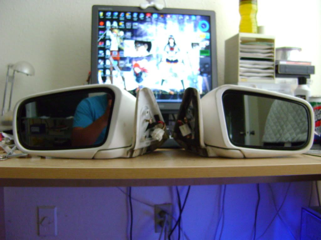

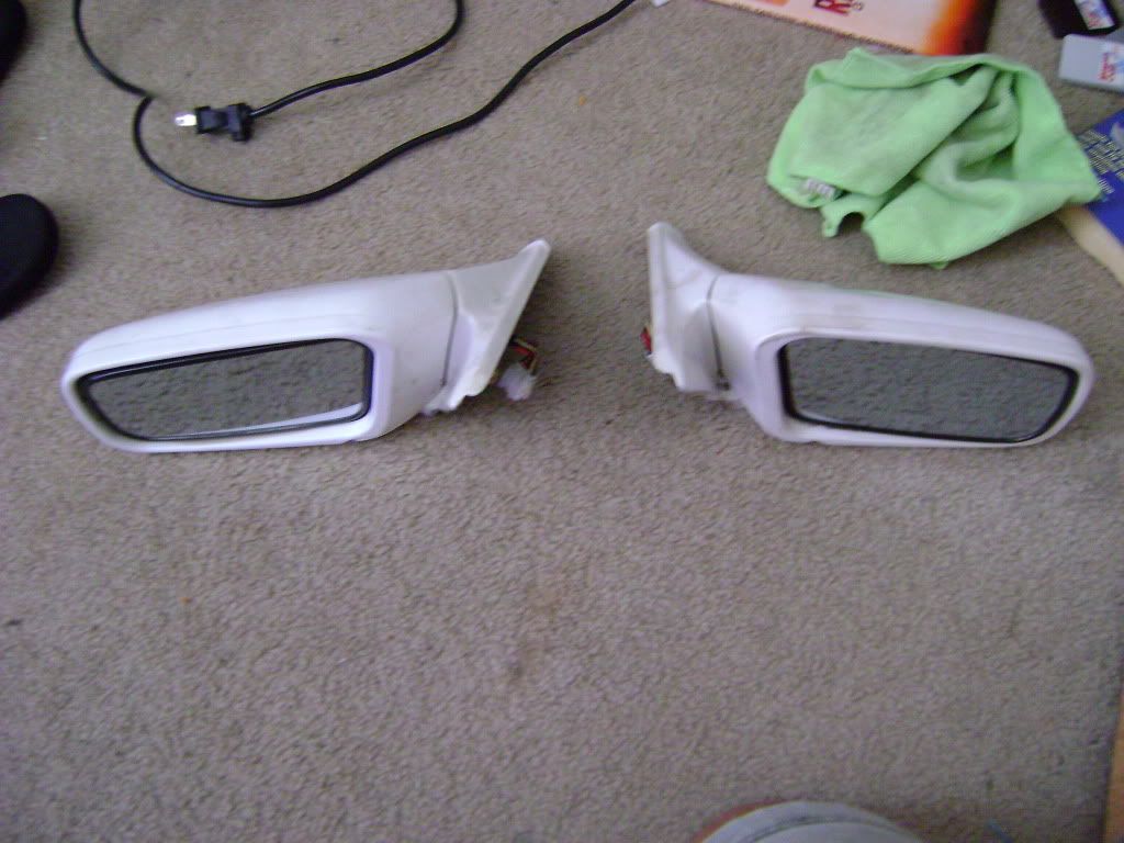

Something came in the mail international shipping would anyone like to guess what it is?
got any idea yet perhaps?
how about now? drumroll please *drumroll*
Tada didya guess right?

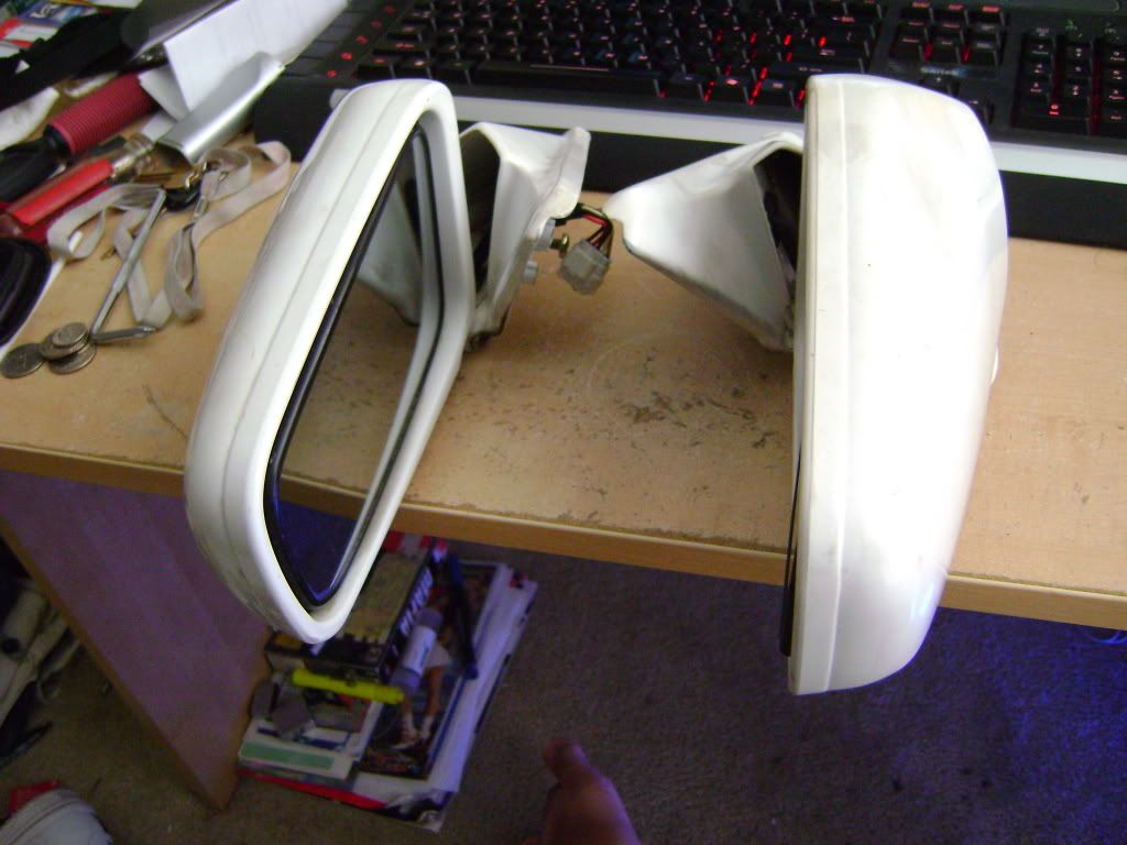

Tell me what you think!

Posted: Aug 23 2009, 06:23 AM
Betrayal Jack Kn..
Posted: Aug 23 2009, 08:11 AM
Posts: 308
Member No.: 2,001
Joined: Jan 17th 2008
Location: Pennsylvania, USA
QUOTE (HateSkylines @ 1 hour, 47 minutes ago)
QUOTE (JDMMA70 @  Aug 21 2009, 09:57 AM)

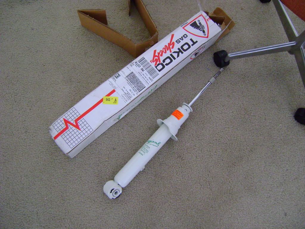

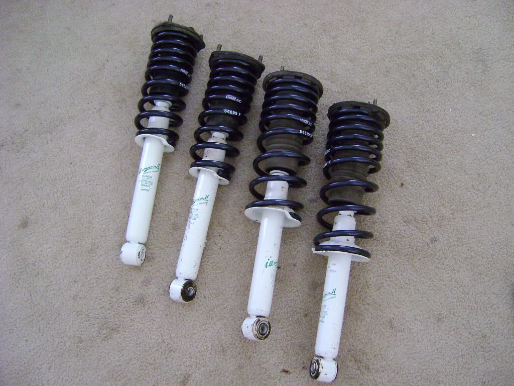

time to give the girl some new legs.
KONG
Posted: Sep 10 2009, 08:06 PM
JTT ・ITB
Posts: 286
Member No.: 4,056
Joined: Nov 19th 2008
I hope you got the Switch, Harness, ECU and Relay for the Power Folding mirrors, or are they Manual Folding Mirrors?

QUOTE (A70<3 @ 30 minutes, 33 seconds ago)
Manual Euro Folding Mirrors, i dont need another headache.
Posted: Sep 11 2009, 05:06 PM
Saves weight. LOL
