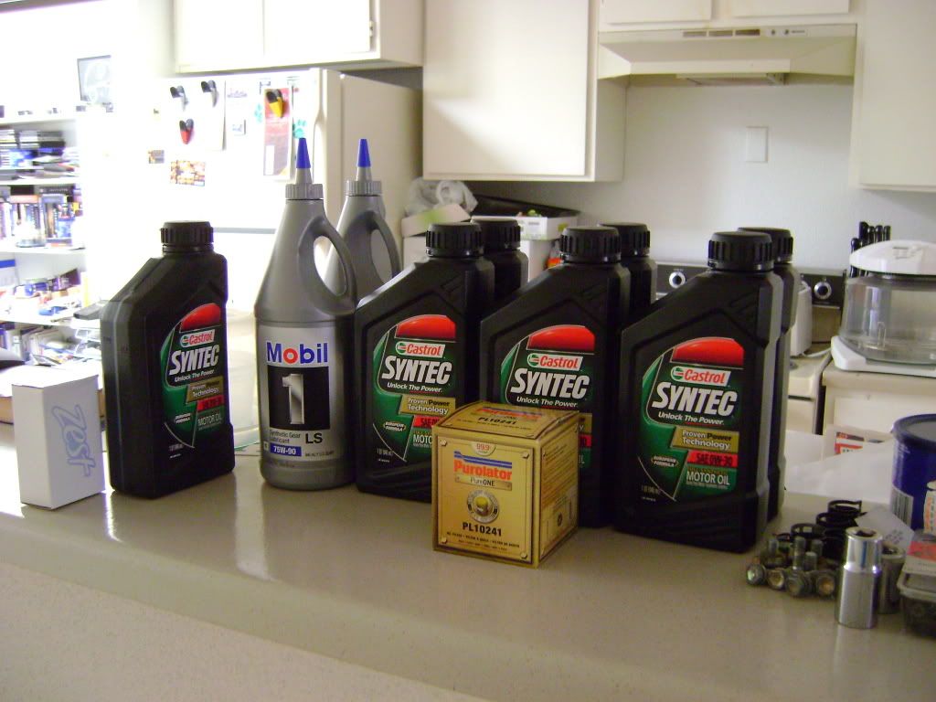

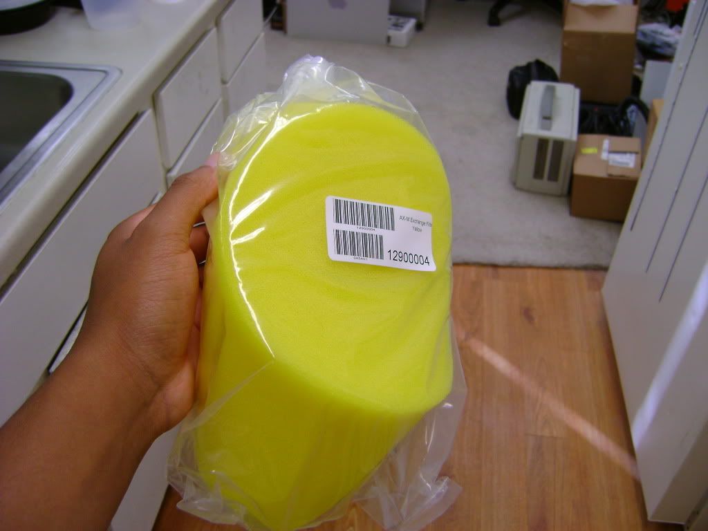

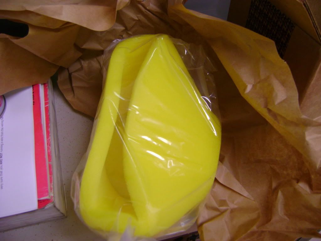

My replacement filter element for my Trust intake came in in from Trust Japan. 3 week wait.
And picked up some fluids to get ready for TX2K10
6qts of German Castrol
2qts of Mobil 1 75W-90
1 Purolator PureOne Filter
Not Pictured
4qts of Castrol ATF
AT Filter

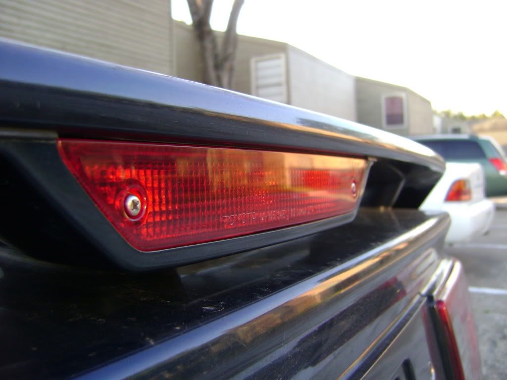

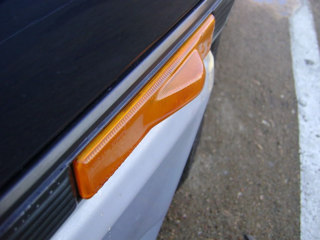

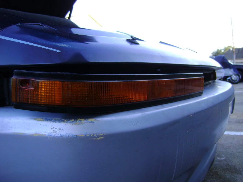

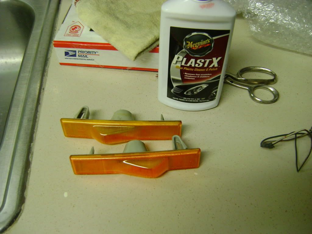

Also got to polishing the plastics on my car.
Wetsanded with 2000grit then polished with rubbing compund.

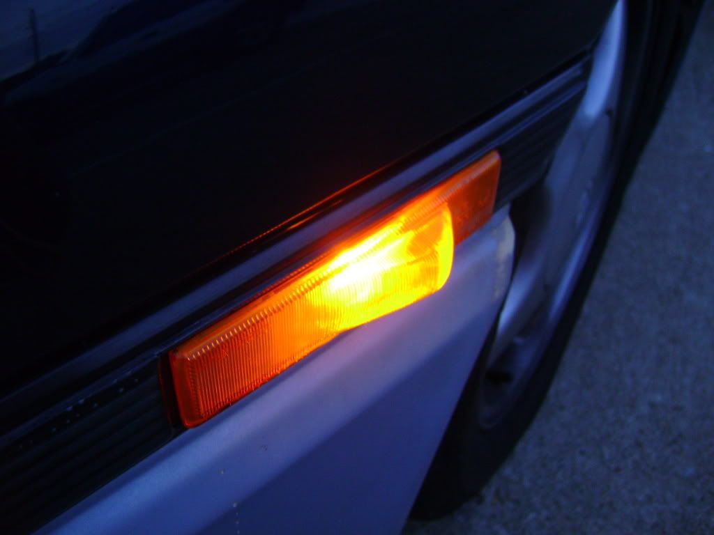

Scored a set of JDM bubble markers off a GA70
Polished those suckers too
Stay Tuned lots to do this coming weekend
To my knowledge the LSD oil has not been changed so it will be interesting to see if it has.
This post has been edited by JDMMA70 on Mar 7 2010, 07:18 AM
Posted: Mar 7 2010, 08:37 AM
Keep it up!
I like the bubble sidemarkers alot more.

Where do you guys get these Purolator filters, online? Can't find them at any local stores. Same with Redline MT-90, no local places carry it so I may end up using Mobil 1 or Valvoline gear oil. Unfortunately most places seem to carry GL-5 equivalent oil, not GL-4 equivalent.

The only place i was able to find Purolator filters was at Advance Auto Parts. I have to go from store to store to get everything i need. I buy my oil at Autozone.
Posted: Mar 7 2010, 04:35 PM
Olyimpic Auto Parts carries my MT-90, and Purlator I get from Pep-boys. Although, my local Pep-boys is ran by real car enthusiests so its alot different from other ones Ive been too.

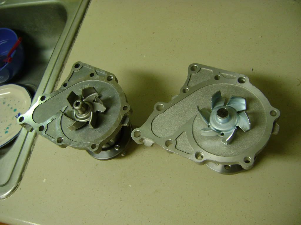

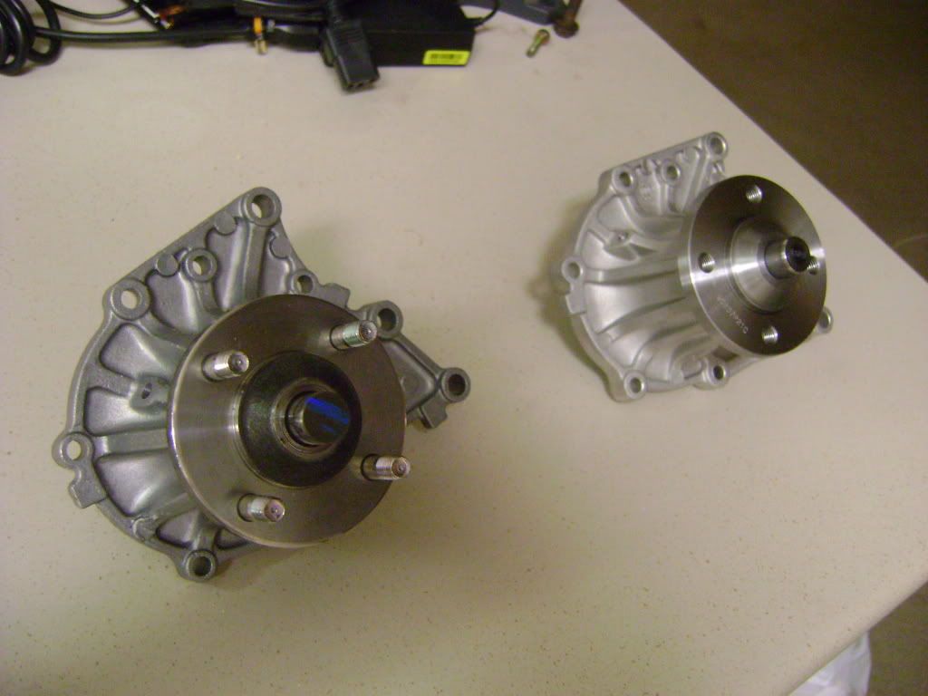

I picked up a generic water pump from the parts store because i didnt want to use my OEM pump on a motor thats not going to be in the car much longer. I was at first scared that the Pump would have a cast impeller wheel. However im satisfied with the construction of this pump.
OEM Toyota/Aisin on the Left, Generic on the Right

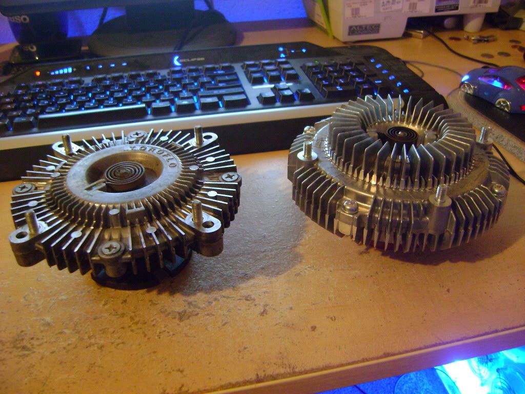

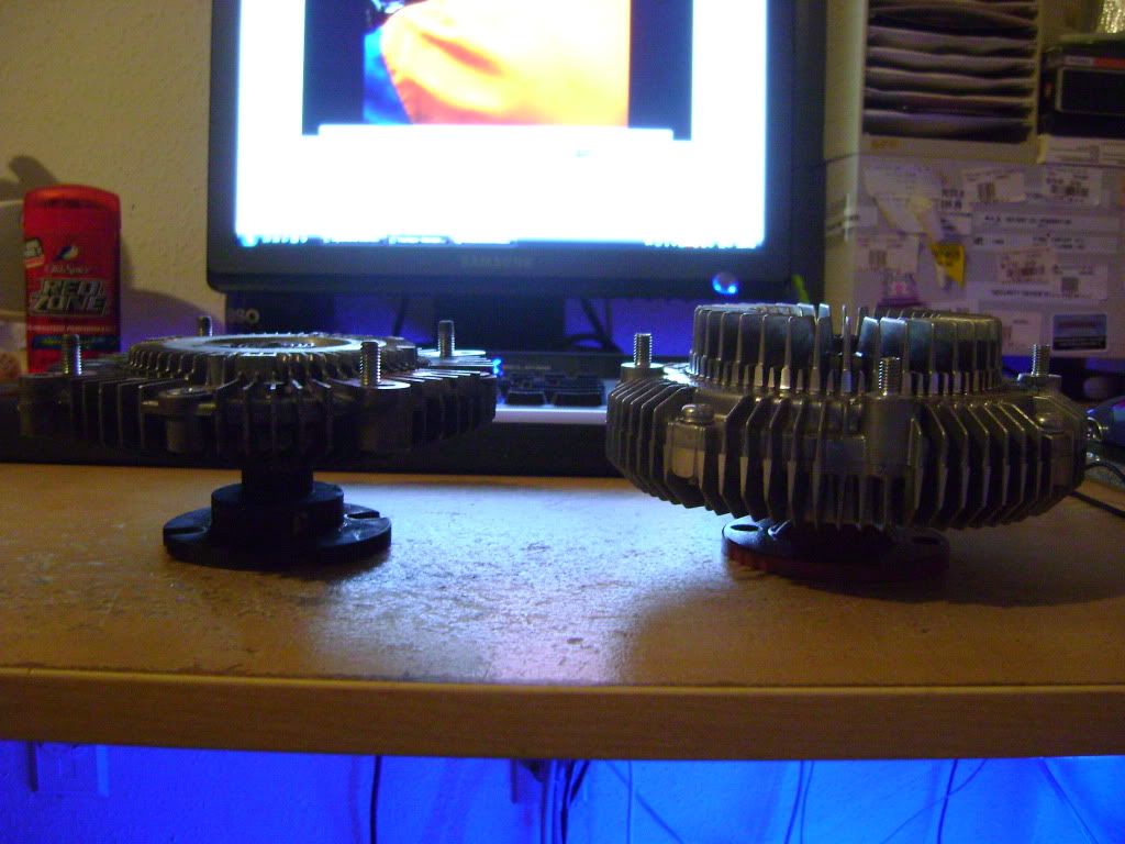

Also replacing the fan clutch.
Yeah.....Autozone replacement on the Left, OEM Toyota/Aisin on the Right.

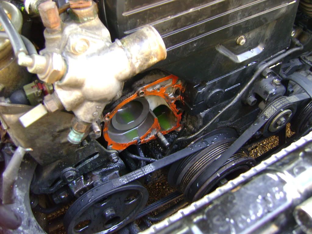

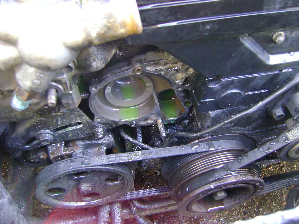

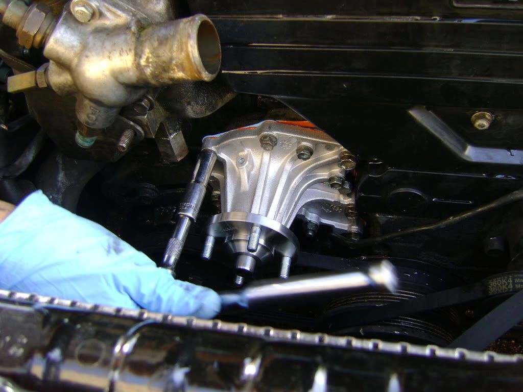

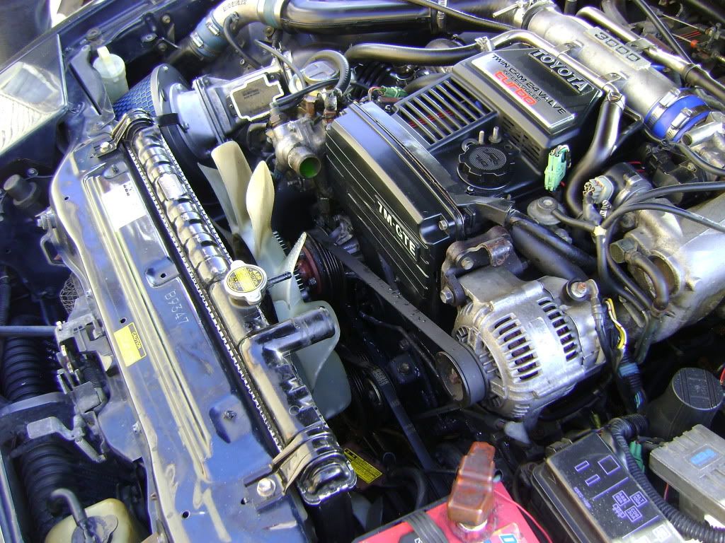

Water Pump and new fan clutch install complete.

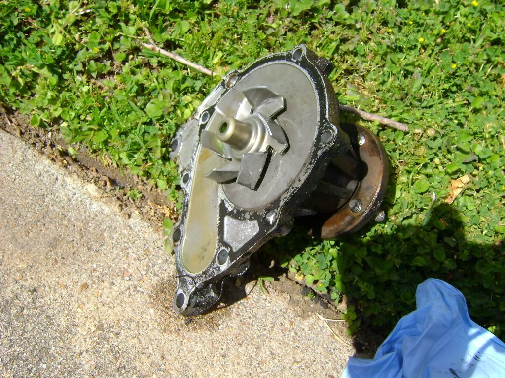

Starting to dismantle
and off the old water pump it looked fairly new. Aisin was stamped on the outside and not on the impeller like the other pumps ive seen. Wonder if the Green Coolant killed it.
Yes im running the evil green coolant but that shit will be out soon
Had no rtv used copper gasket instead
installed
more poison
Done

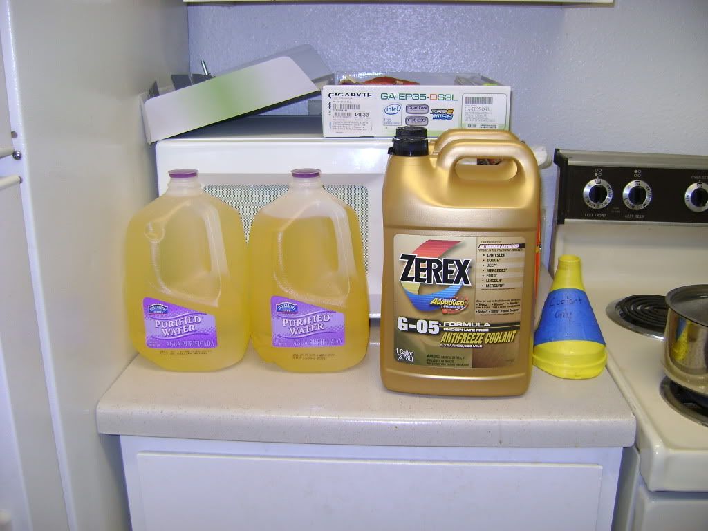

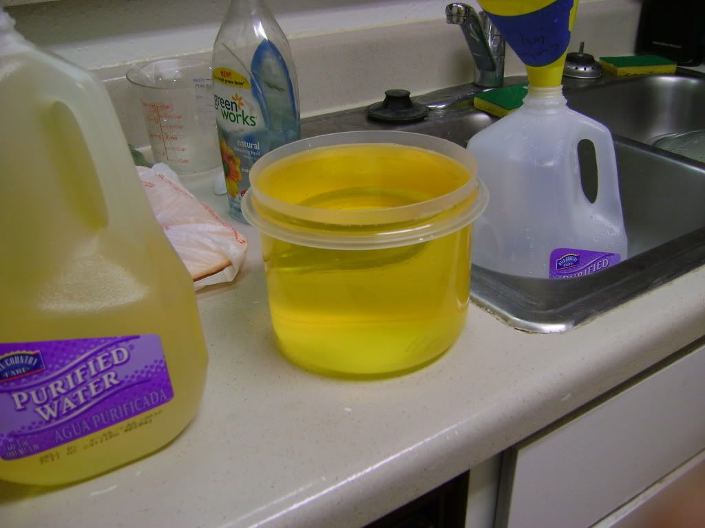

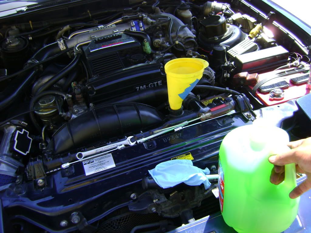

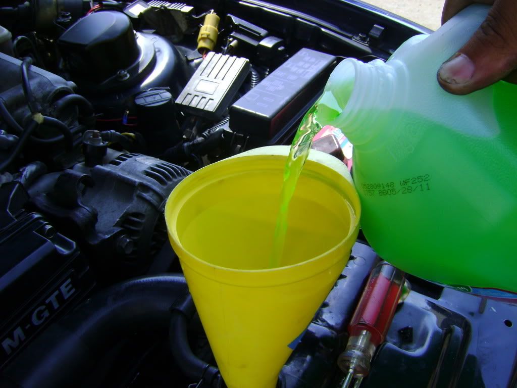

Now today i got rid of the old green autogaurd/prestone/peak coolant mix. Flushed out the rad, engine and heater core.
Zerex G-05 getting ready to dilute.
all finished i bought two jugs so i could have extra coolant incase i needed it.
Car is running noticbly cooler than before so thats a plus

Posted: Apr 3 2010, 08:03 PM
Funny that you're actually happy about the stamped impeller on the water pump. Most L-engine guys avoid them at all costs, and prefer the cast type.

Green Coolant is usually High in Silicate which causes the aluminum in the head and block to errode. Since most foreign engines are made out of a different combo of metals. They formulate Coolant to fit the engine. Theres a BIG difference in formula in Toyota Red vs Prestone. You want a coolant thats Phosphate Free, Borate Free, and very low in Silicate or Silicate free all together. I have a block that was run on nothing but Green Coolant for about 15,000 miles. There is some serious pitting around the water jackets on both the head and the block. Toyota Red also leaves a protective film that protects and lubricates the cooling system parts for extended life. Zerex G-05 and Zerex for Asian Vehicles also are formulated the same. Various Factory coolants are as well specifically, Asian and European coolants. And everyone knows not to run Deathcool
