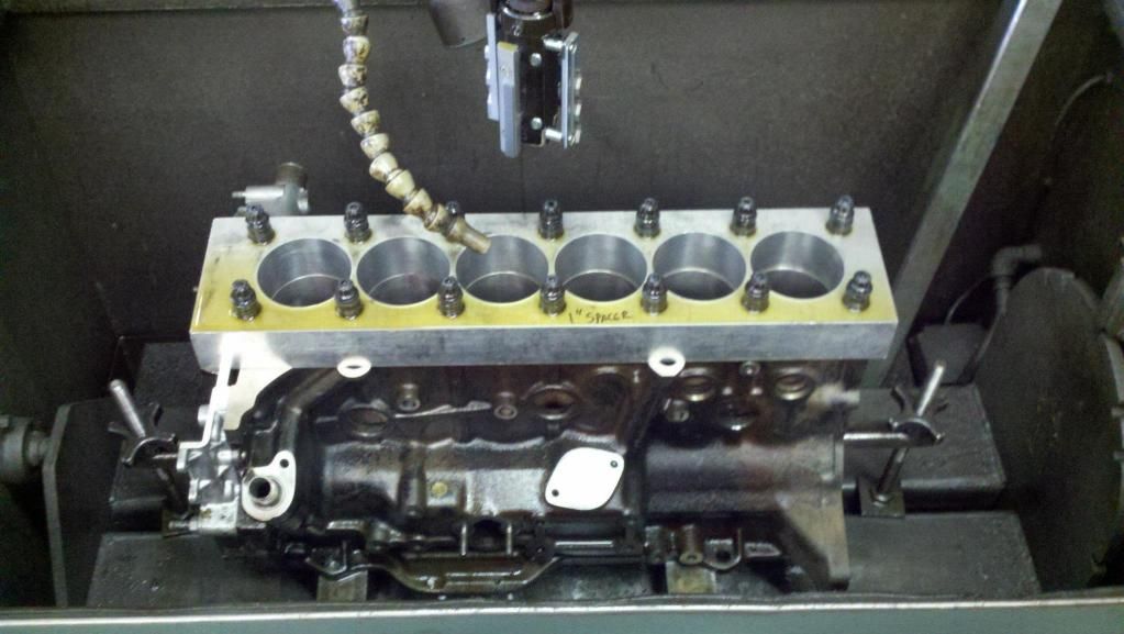

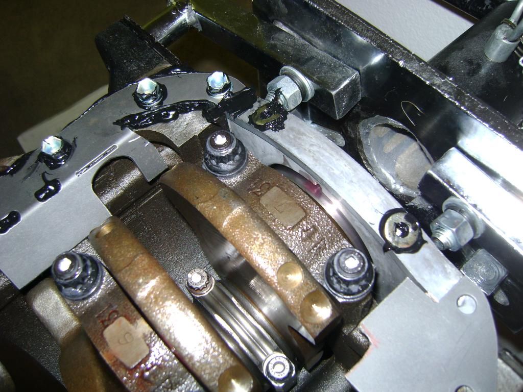

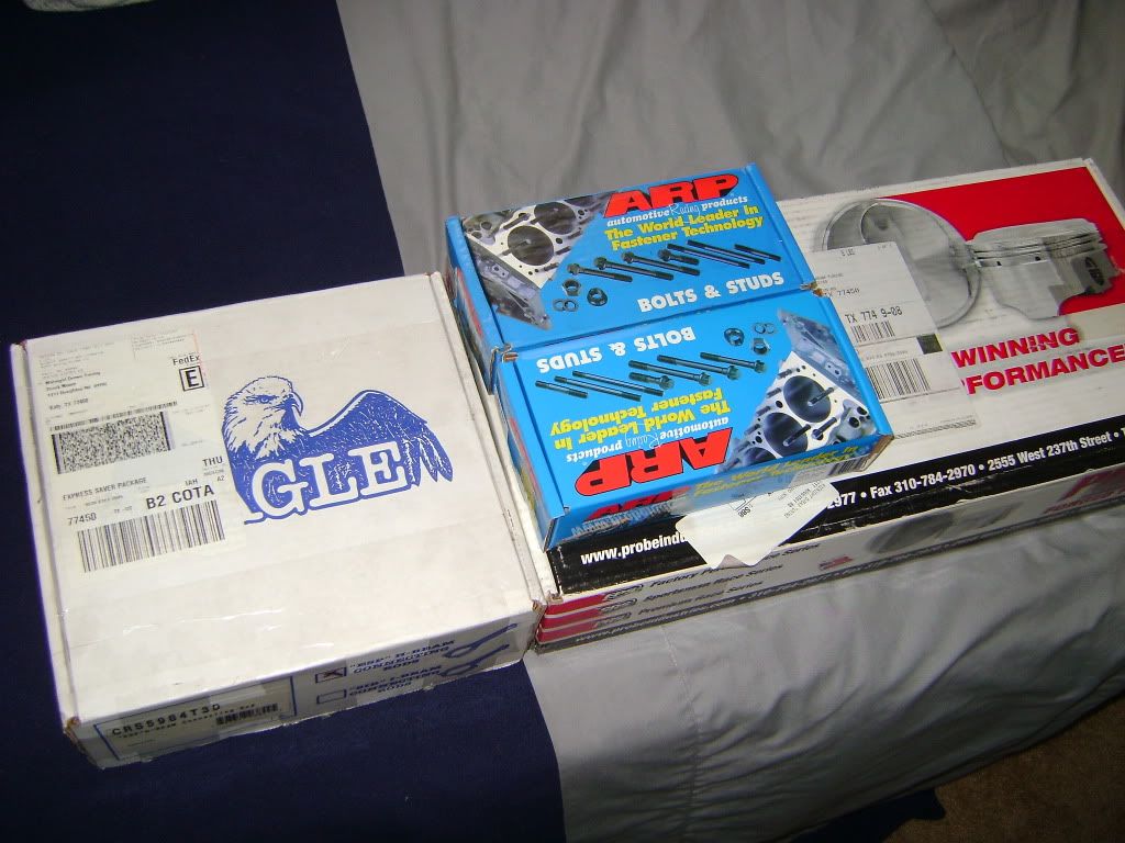

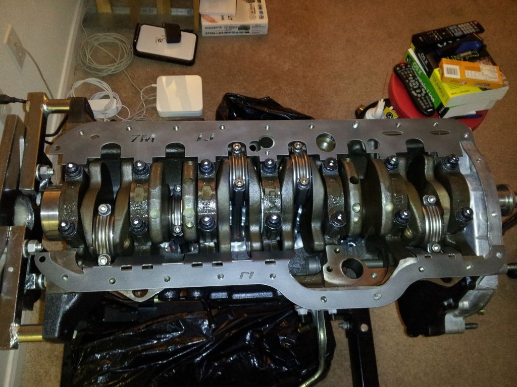

So if anyone remembers my rebuild that seemed to be on hold well not anymore. Started Collecting the final bits and pieces needed that the machine shop will need.
So heres where I stand now pictures below are the same internals i purchased 4 years ago plus with the new addition of ARP Head Studs.

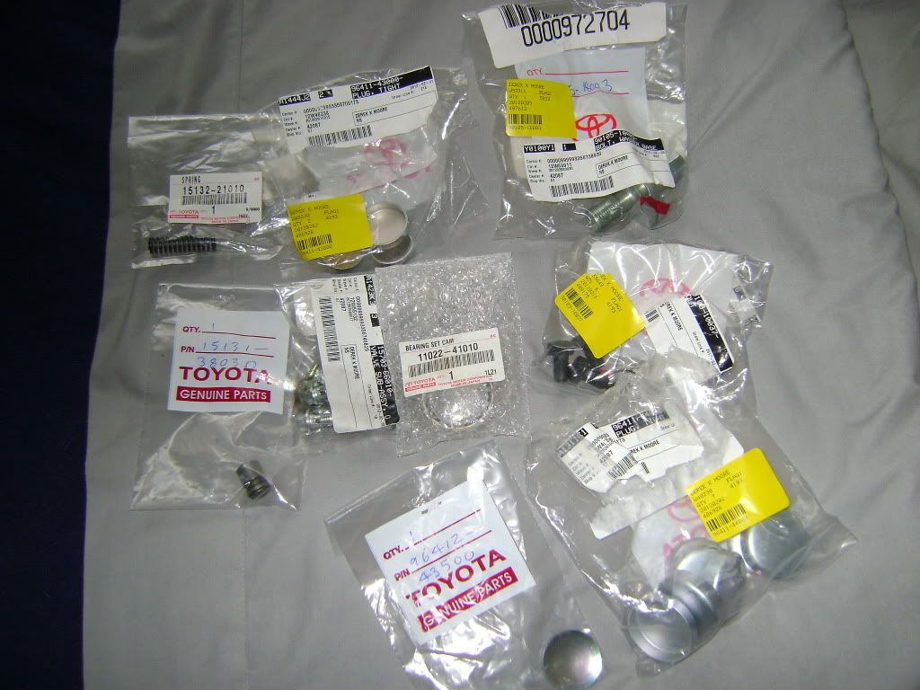

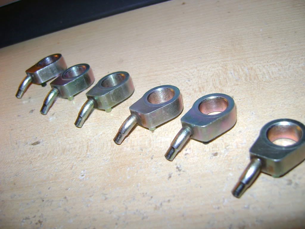

Cleaned up the Oil Squirter Nozzels at work today using the parts washers. Took the 18+ years of varnish off they look brand new. I have new bolts for these. OEM Parts pile below this pic.

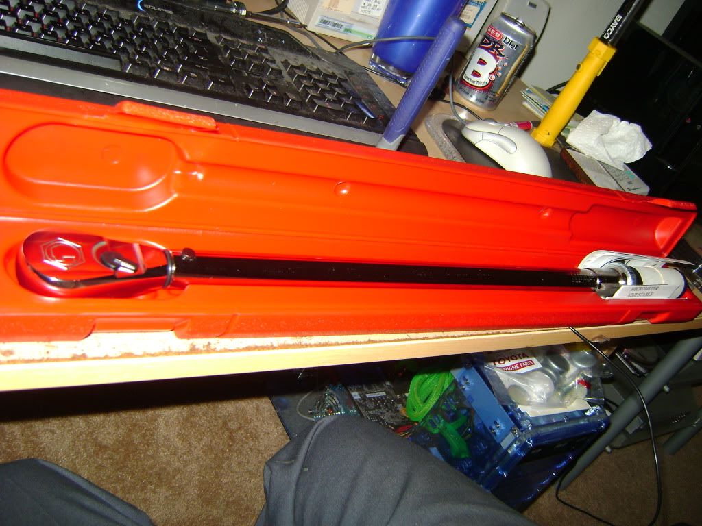

Also decided to pick up a new torque wrench just to make everything feel fresher.
More updates coming tomorrow when the torque plate arrives.

Motor is at the machine shop right now dropped it off tuesday.

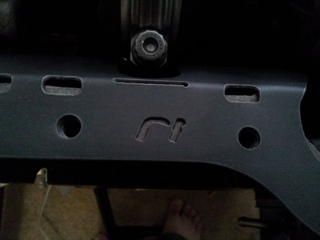

Torque Plate arrived so now we wait.

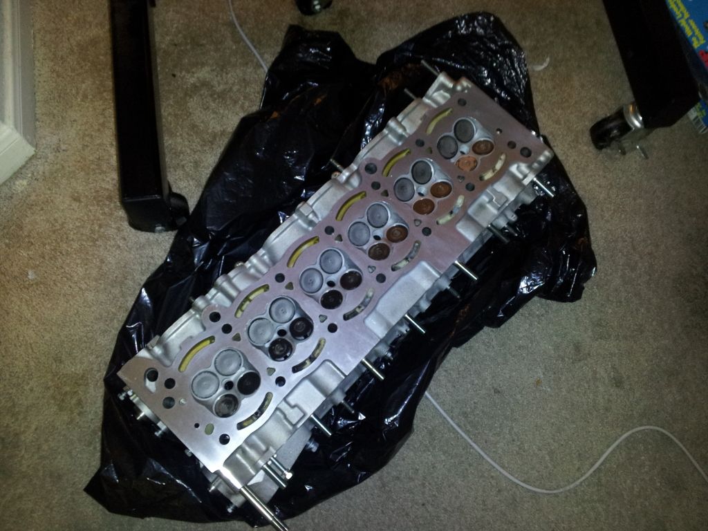

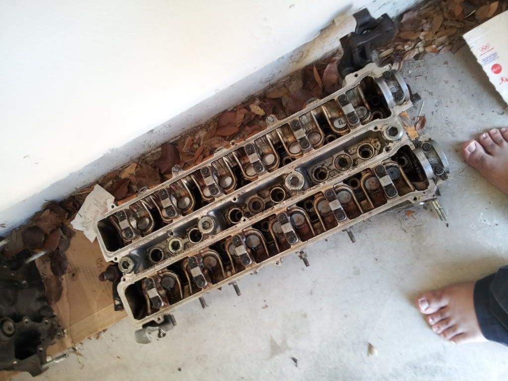

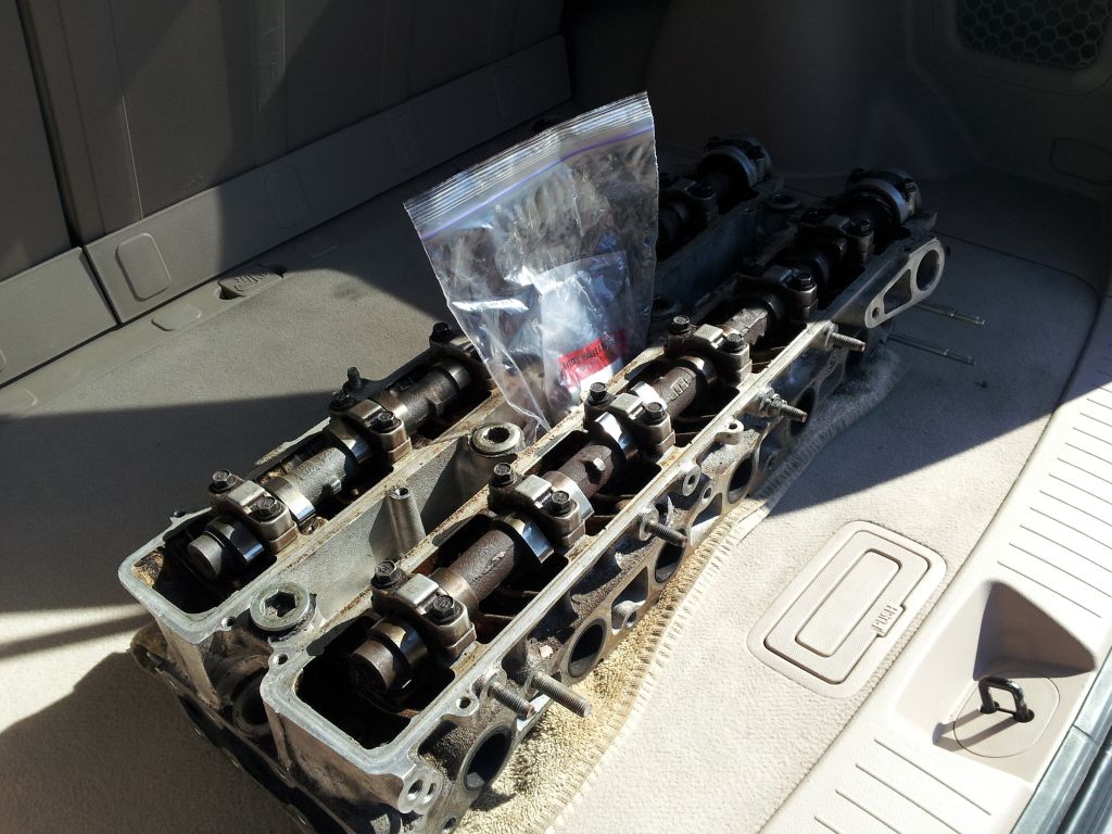

Picked up the head that will be used for this motor today pics below. This is off a 90 Cressida so it one of the last "performance based" heads Toyota did for the 7M Cast #14 the later heads were more for fuel economy rather than performance. Its also never been machined making this a virgin head also never suffered a BHG.
This post has been edited by JDMMA70 on Mar 22 2012, 07:48 PM

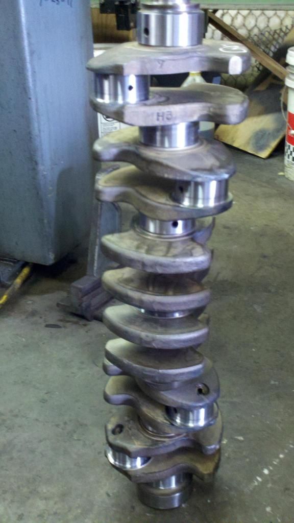

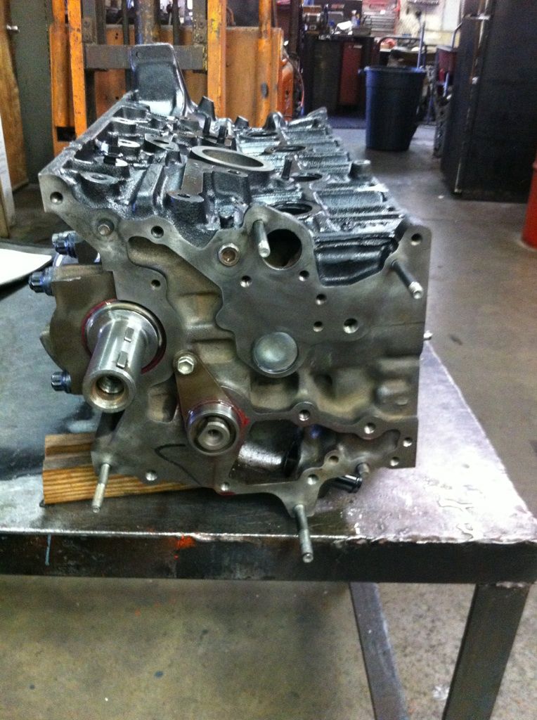

News from the machine shop, crank has been ground, the block is currently being bored.

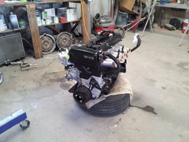

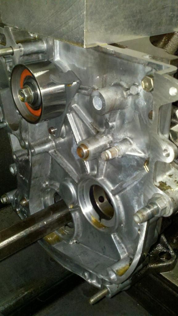

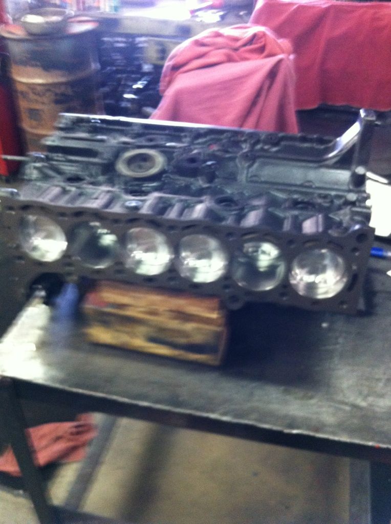

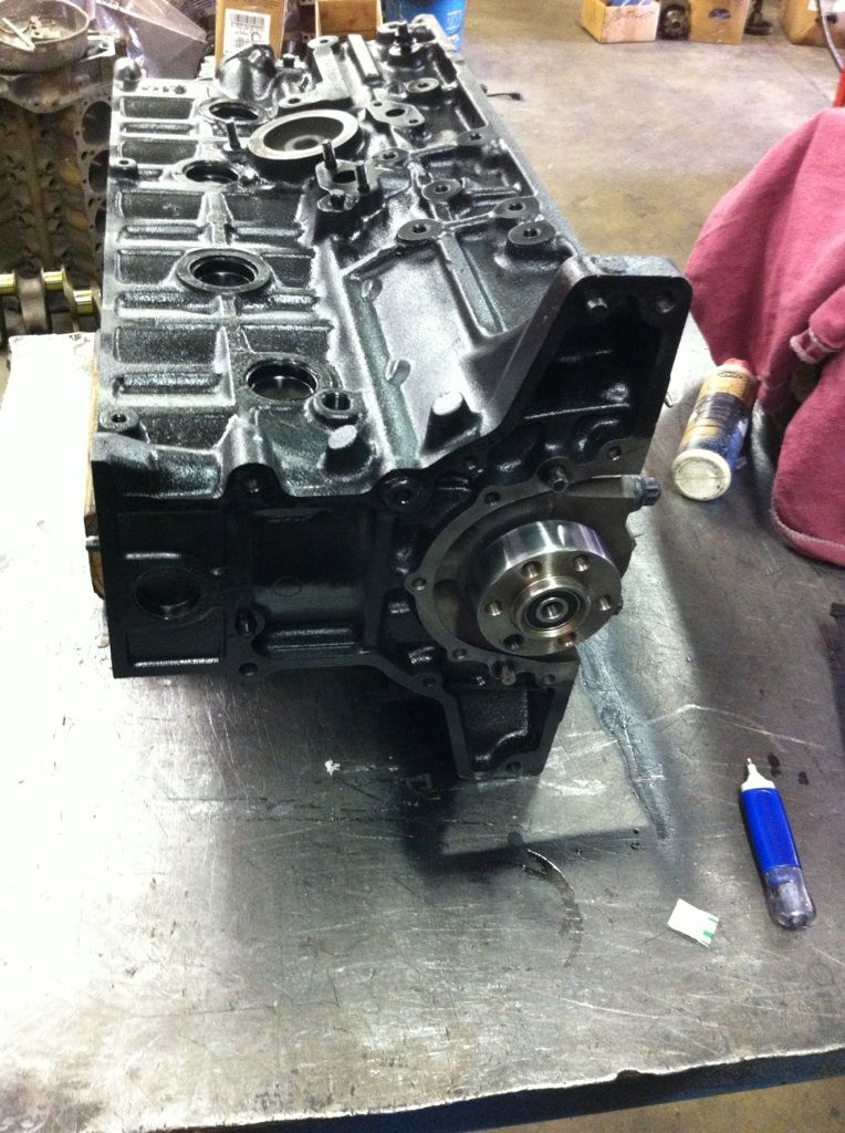

Short block is finished going to pick it up next week when i get to borrow my friends van. In the mean time.
Sorry for the shaky last picture
Better pics to come once shes home.

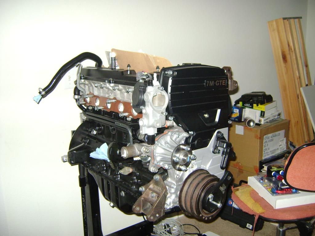

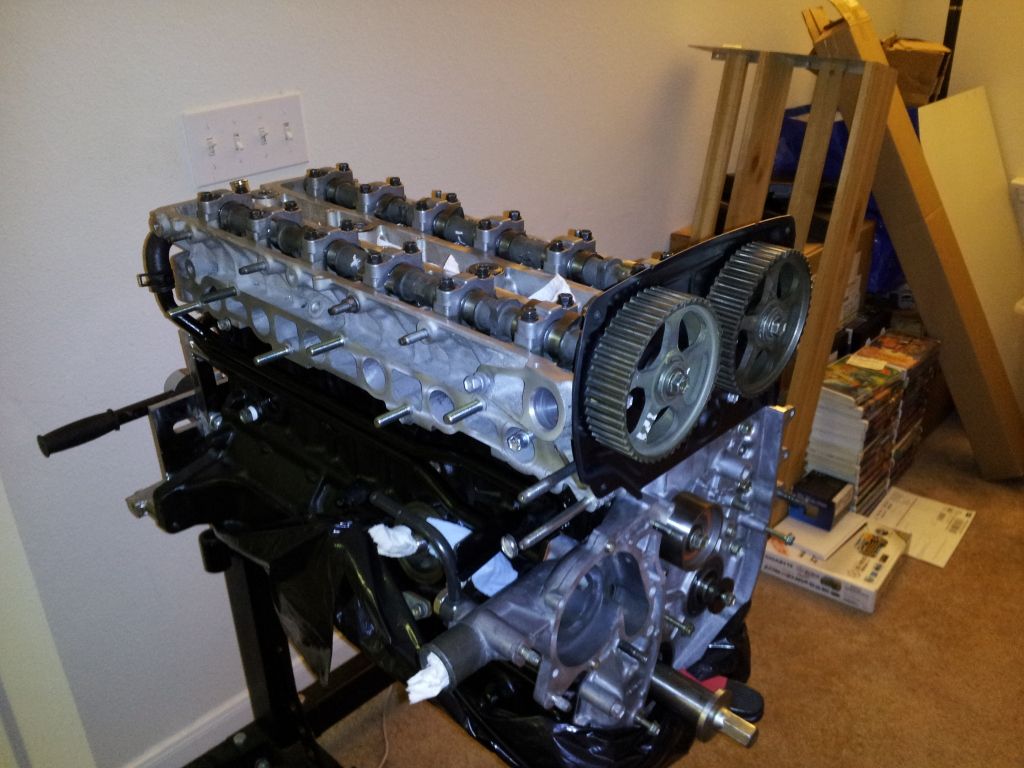

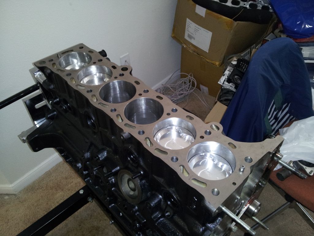

Well Update engine is 75% assembled. Needs oil pump, oil feed line, and I need to finish the oil cooler circuit.

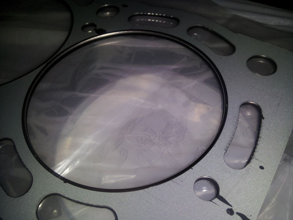

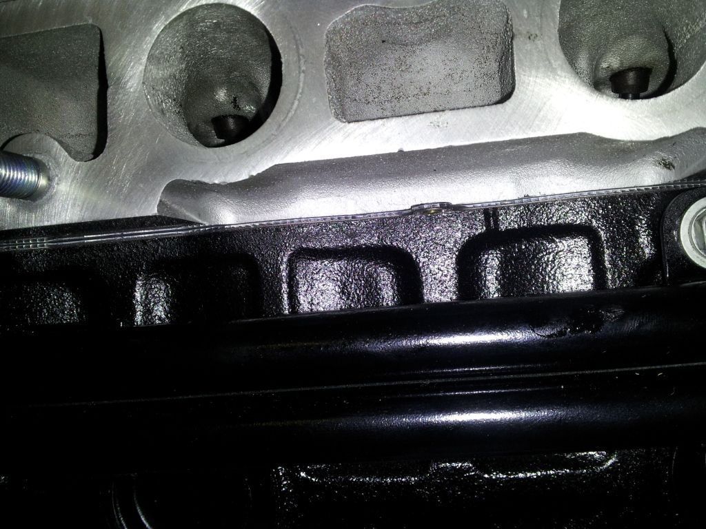

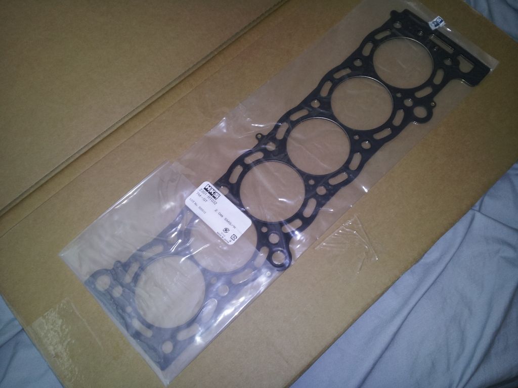

HKS Stopper I had to wait a month for this thanks to HKS USA closing up shop here. No supplier had any left in stock in the states. Worth the wait these are quite impressive.
you can really see the stopper ring around each cylinder hole.

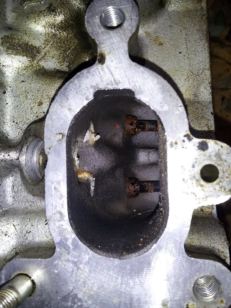

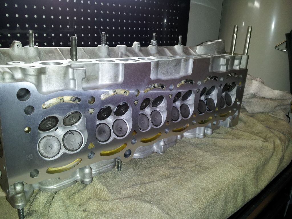

I took the head to the machine shop, decided for a basic rebuild, 3 angle valve job, and have them install my new valve springs in anticipation for cam upgrade in the future.
Head ready for the machine shop
Fast forward a month, yes a month i dont think they were in a rush with my stuff....
Block awaiting its crown.
good conversation piece no?
Test fitting the crank scraper

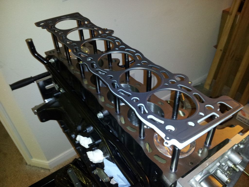

Headgasket compressed at 90ft lbs
More to come soon

dat smexy motor...is it a 7M?
and turbo?
JDMMA70
Posted: Oct 27 2012, 08:03 PM
Posts: 786
Member No.: 123
Joined: Apr 7th 2007
Location: Houston, TX
Yes indeed it is a 7M and yes it is the turbo variant

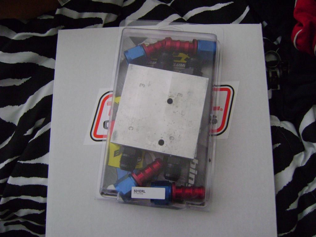

Big update

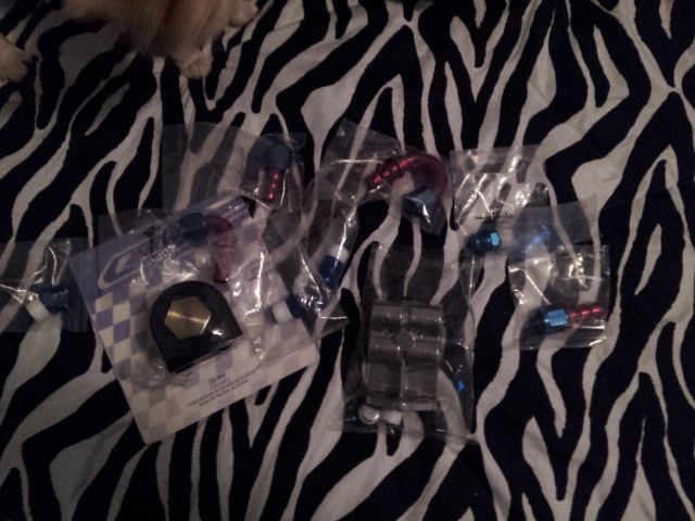

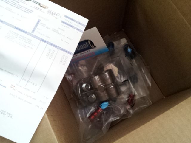

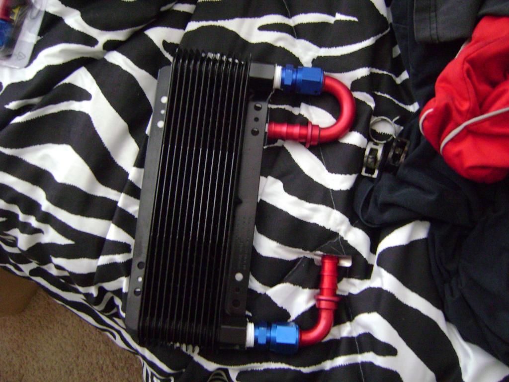

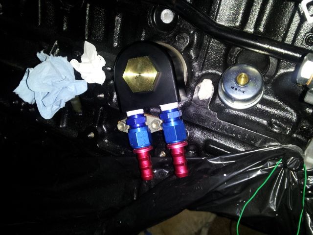

Starting piecing together my full flow oil cooler setup got a few bits in.
Box from summit

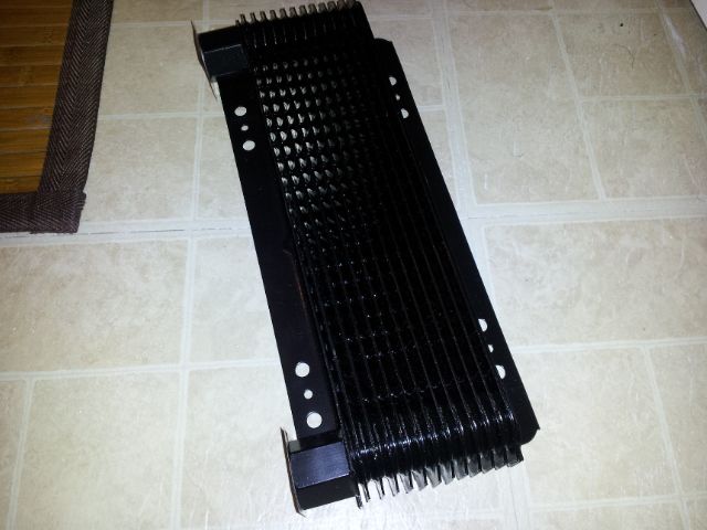

The oil cooler i got came in a few days ago. Im going to mount it in the stock location, its a 12 row.

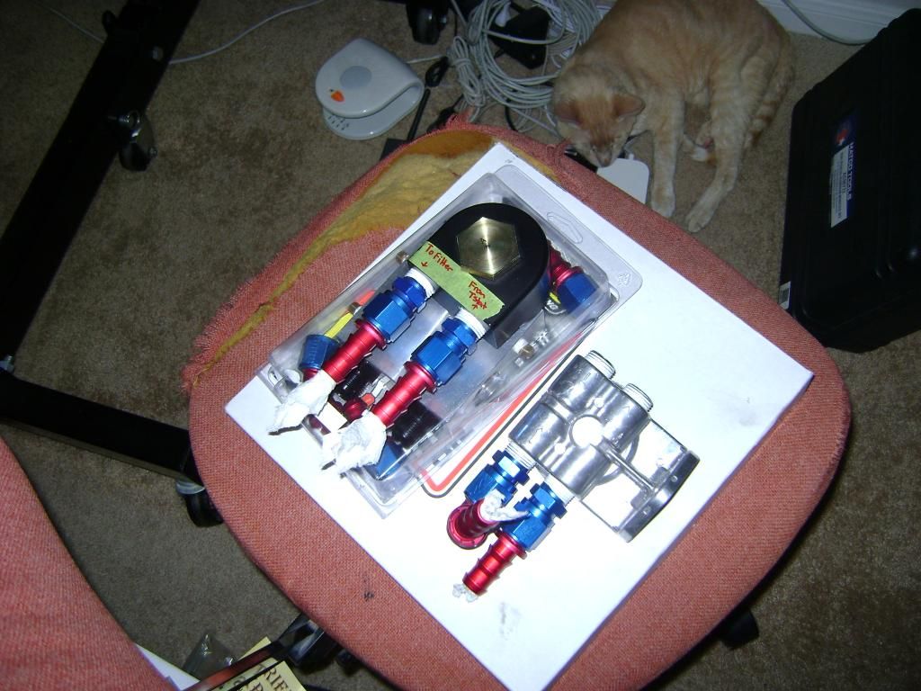

Last of the goodies i need to set up my oil cooler.
I went with the Earls 180 Tstat need to figure out where to mount it
Fittings look funky but itll allow me to use it in the stock location.

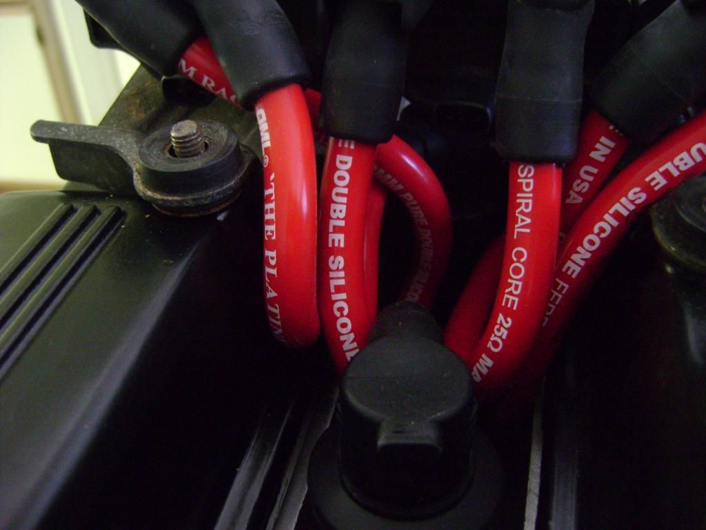

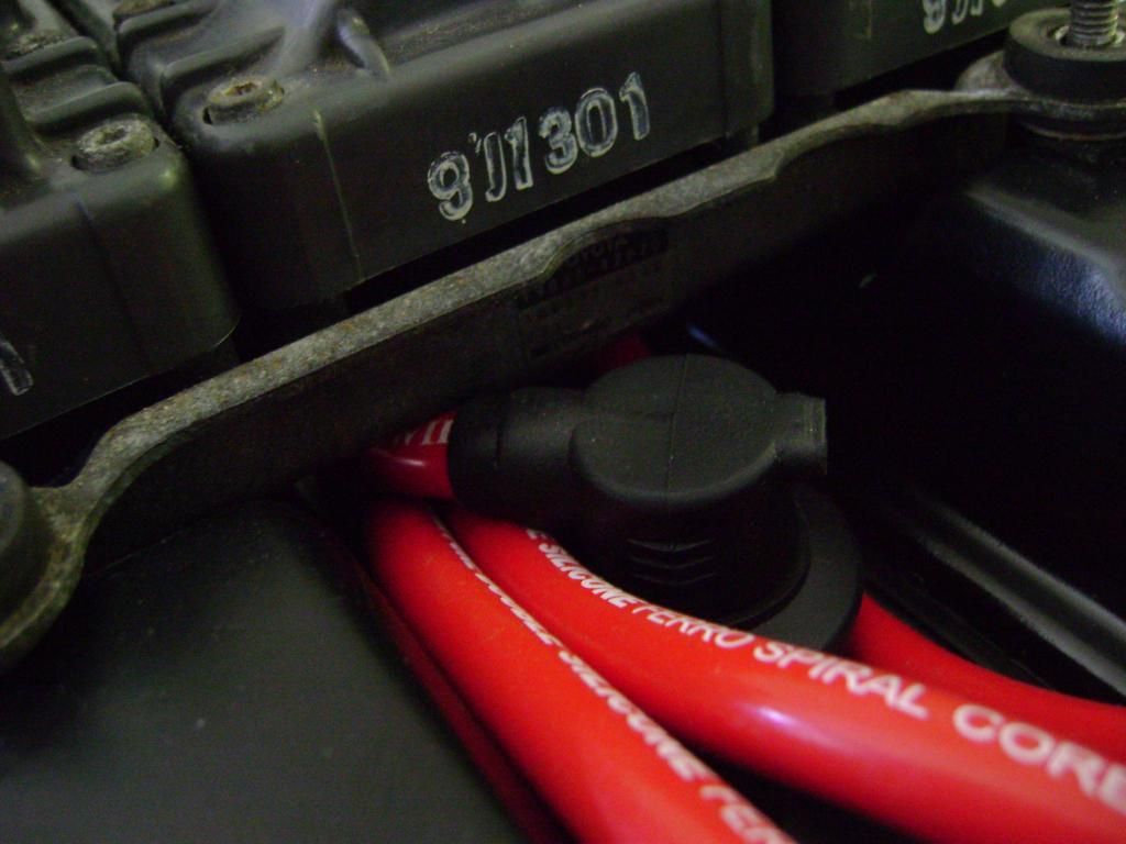

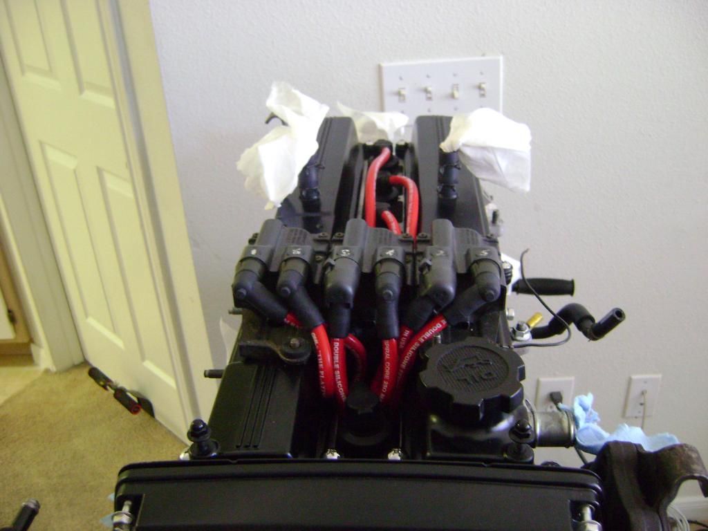

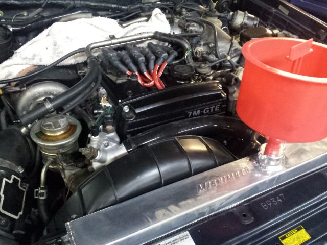

So my pops ended up getting me those 10mm Plug wires and damn they are thick. Slightly longer and taller than stock though. Im currently messing with them on the stand trying to find out the best way to cleanly route them.
They look awesome with the black valve covers.
Lots of pushing and tucking haha

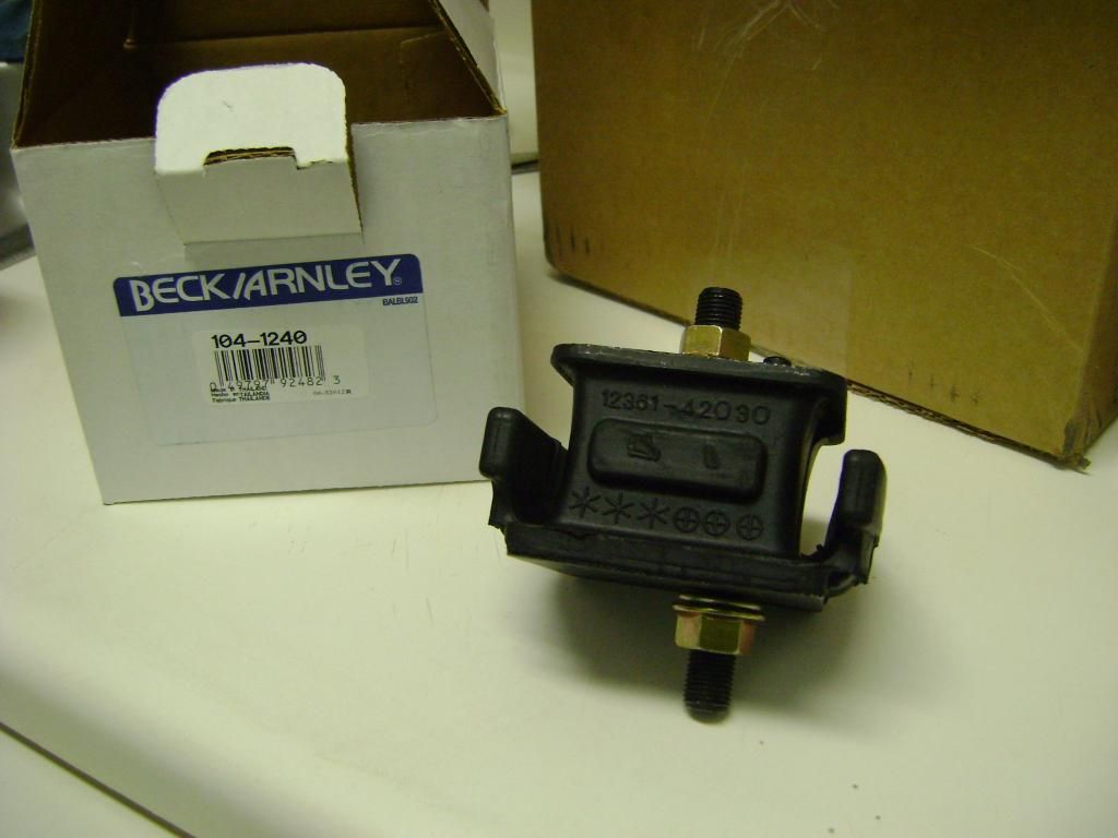

OEM motor mounts came in, thank you RockAuto.

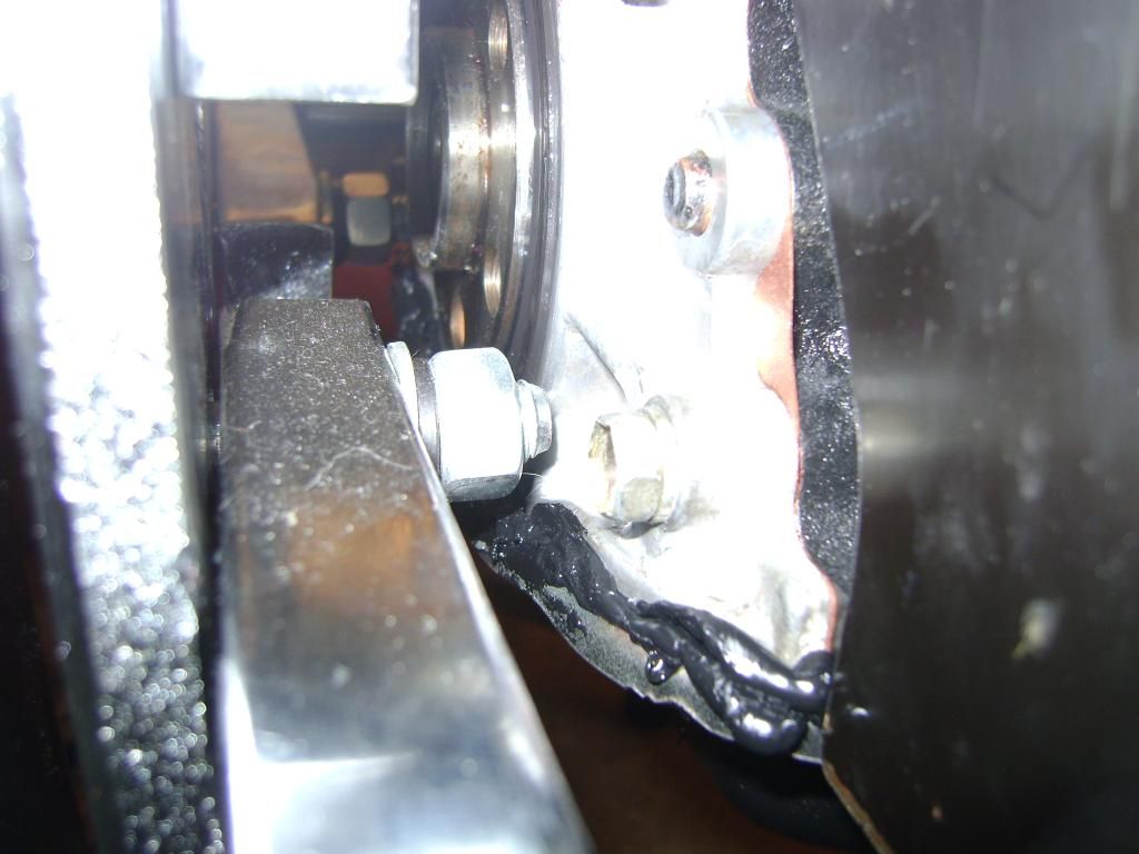

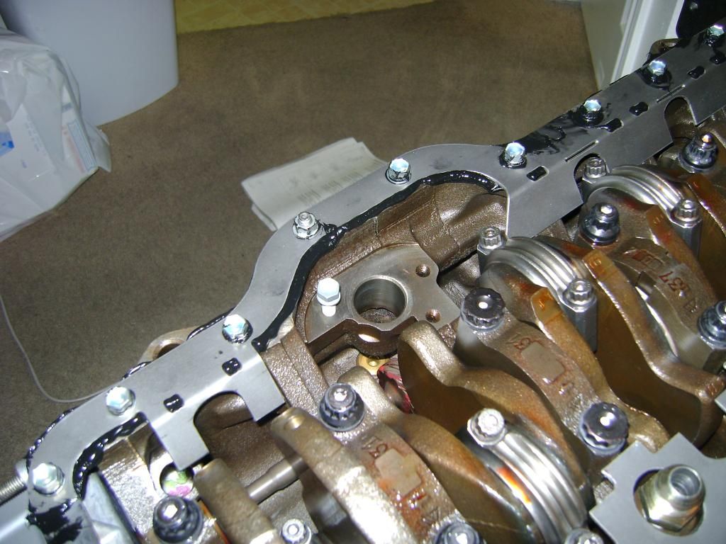

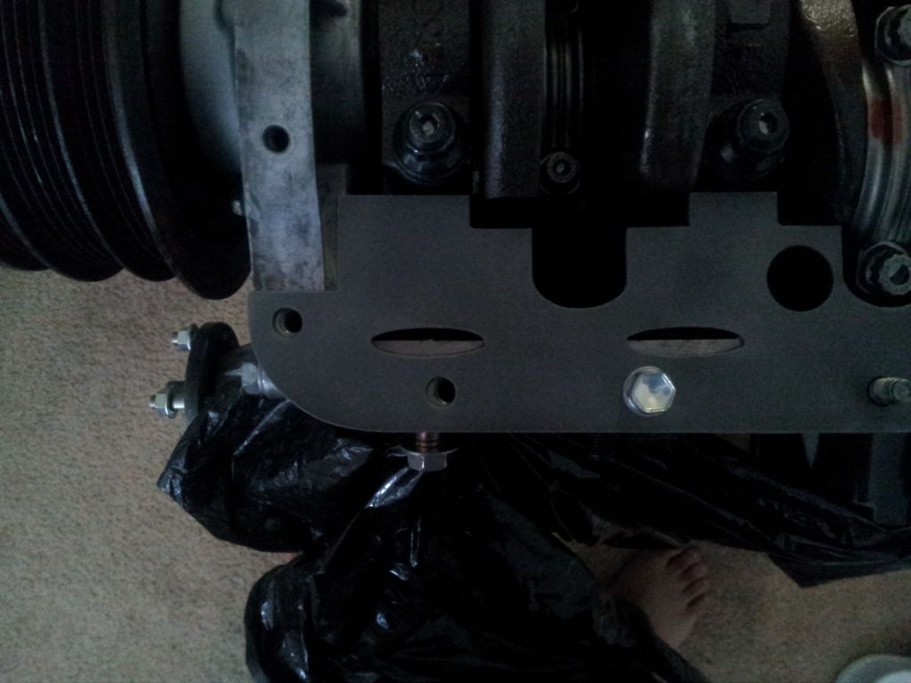

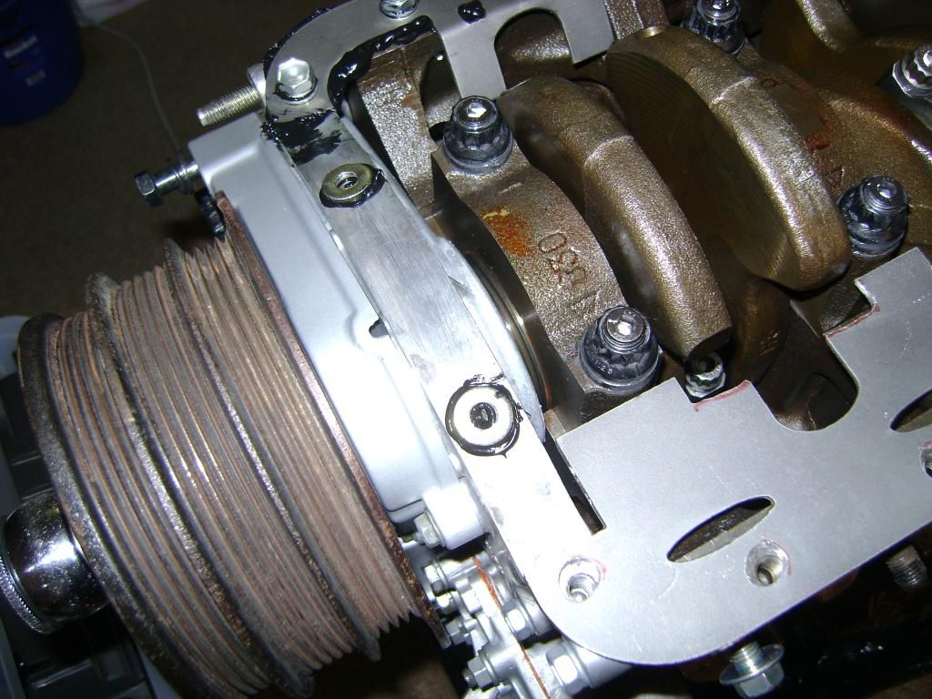

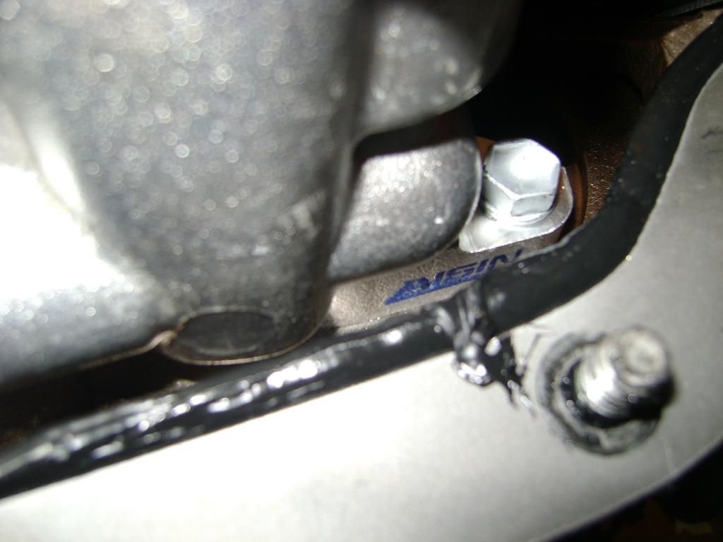

Fitted the crank scraper had to dremel some of the bolt holes as they were off slightly.

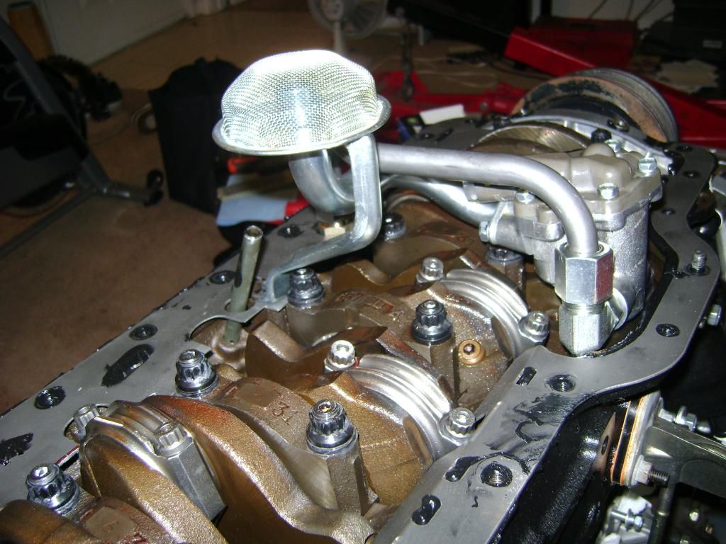

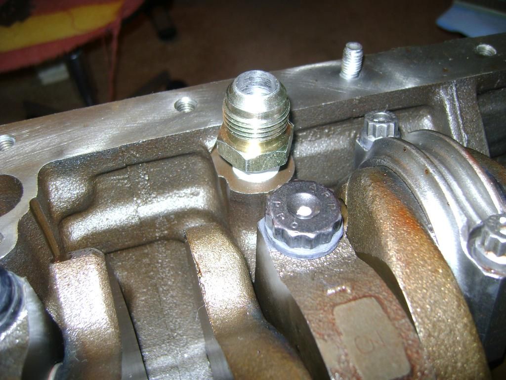

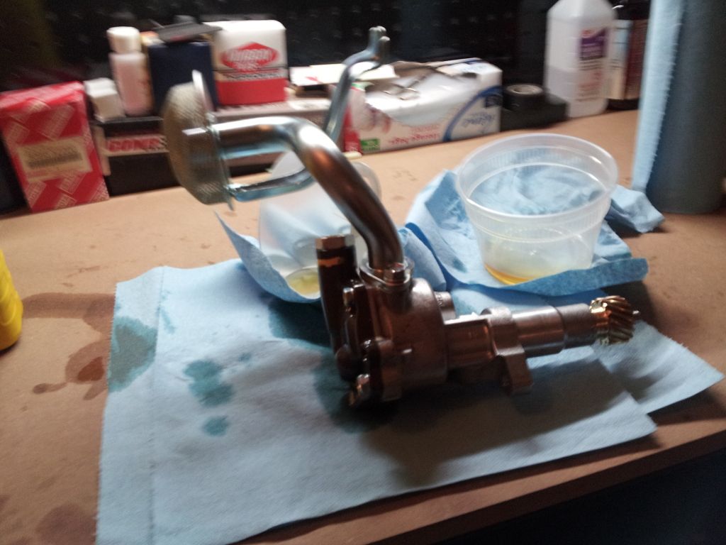

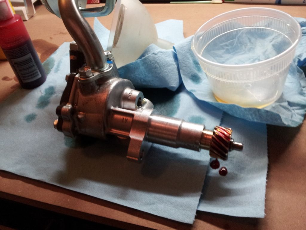

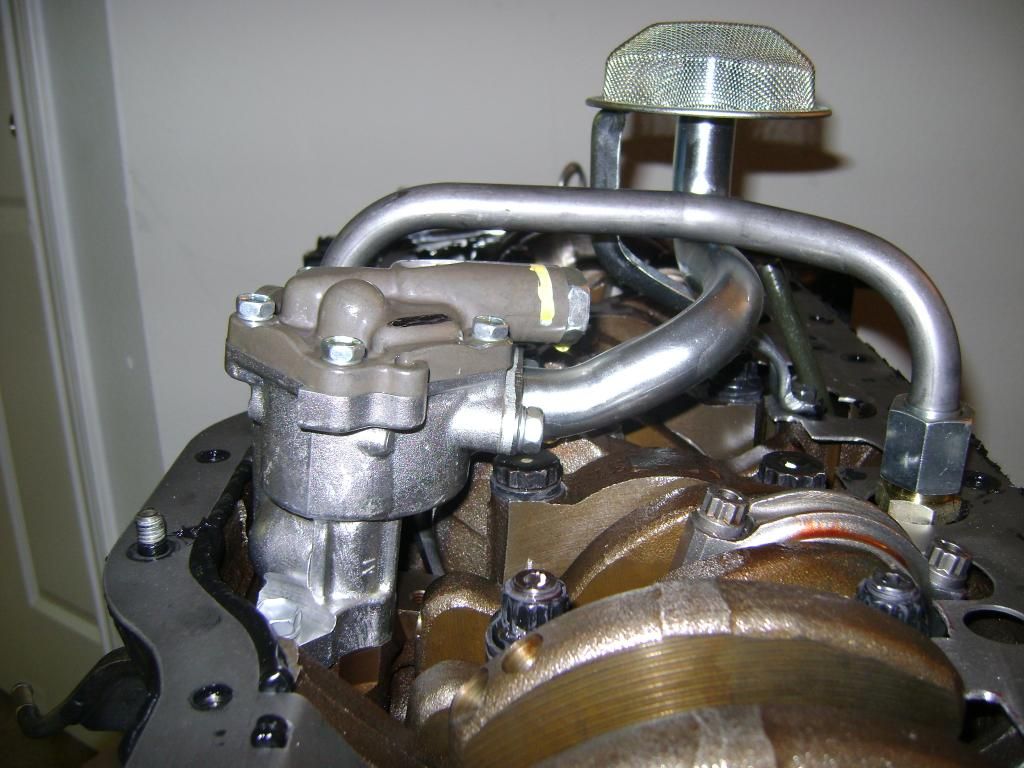

Primed the oil pump, and fitted the ARZ Hardline.

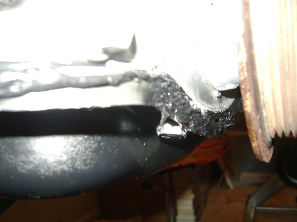

FIPG makes such a big mess...
Used a f**kton and a half of FIPG....hey i dont like leaks...

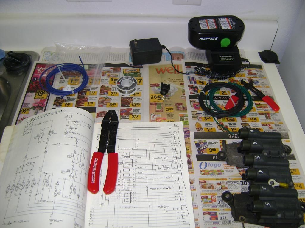

My pops finally started work on the wiring for me, as we are getting ready to drop the motor in next week. So the starter will have fresh wiring, as will the cold start injector.

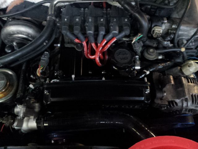

I mocked up the Oil cooler, and the other tid bits today so I knew how long my hose had to be. Of course the picture wouldnt be complete without my cat chillin in the background.
A better picture of how she sits now

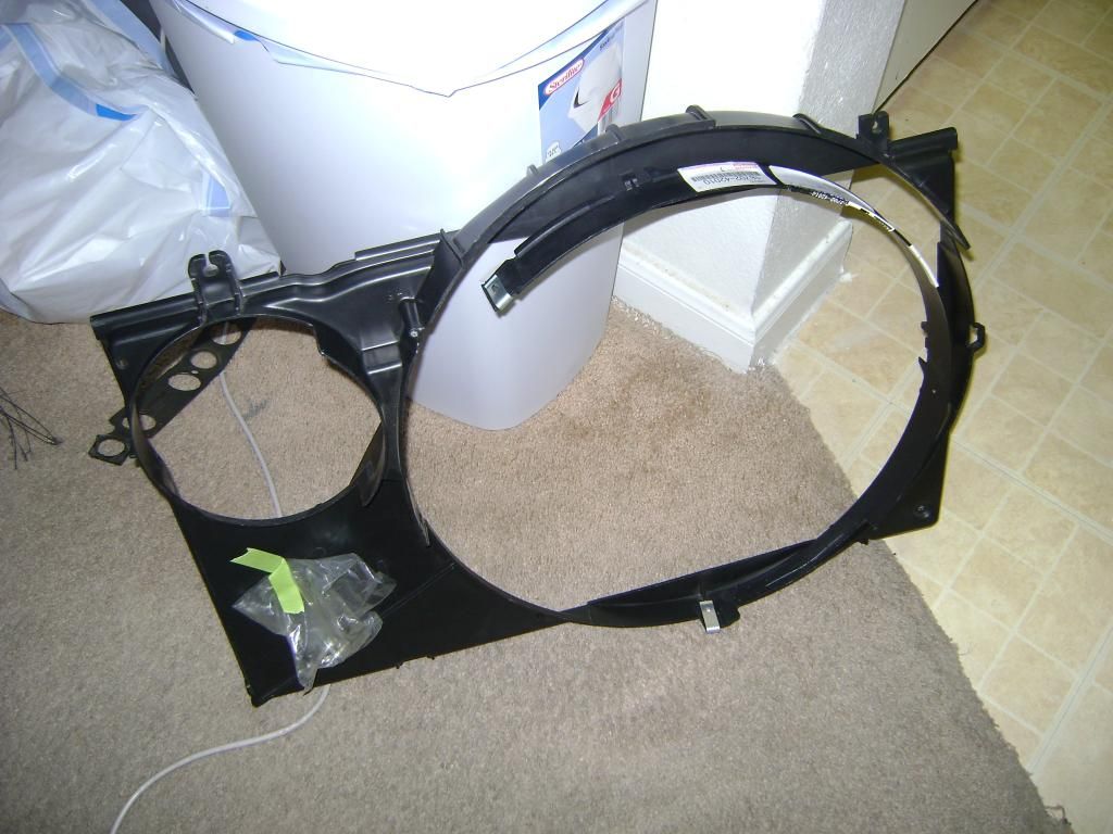

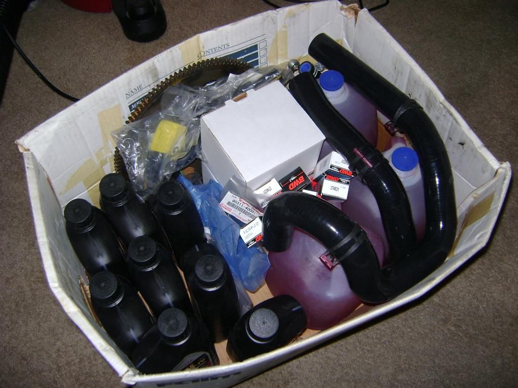

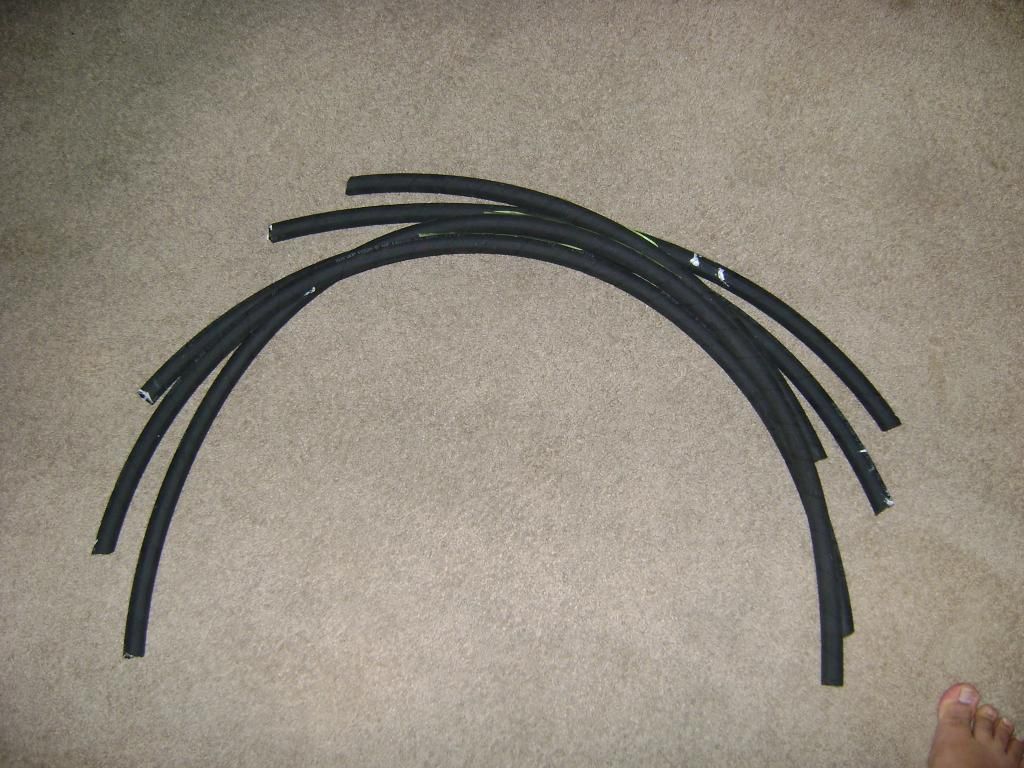

So I started organizing all the pieces that will be going on during the swap. New shroud to replace my broken one.

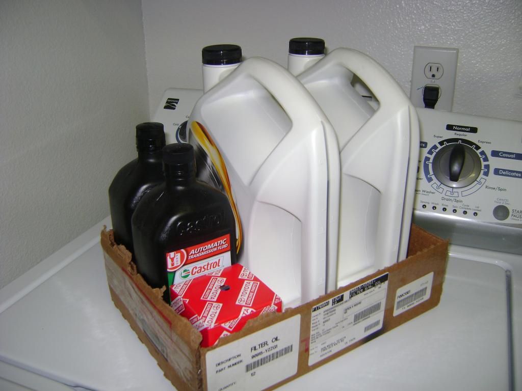

Break in oil Rotella T1 Straight 30W, ATF for PowerSteering and a Toyota D3 oil filter (I bought a bunch of those when I was working at the dealership)
Toyota Red, Toyota T-IV, Hoses, motor mounts, and other goodies to help the swap and start up process smoother.

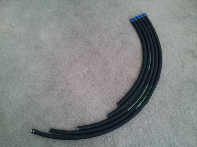

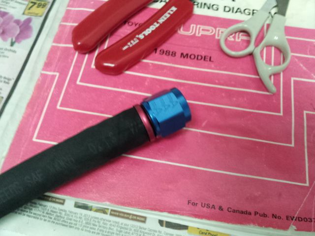

As of today I Assembled some of my hose.

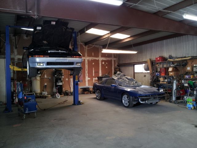

Teaser....
Blue-Sensei
Posted: Jun 25 2013, 04:05 PM
I have no idea what I'm doing
Posts: 1,074
Member No.: 7,637
Joined: Jan 16th 2011
Location: Virginia
...Is that your garage?
JDMMA70
Posted: Jun 25 2013, 04:24 PM
Posts: 786
Member No.: 123
Ope I wish

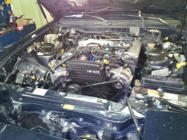

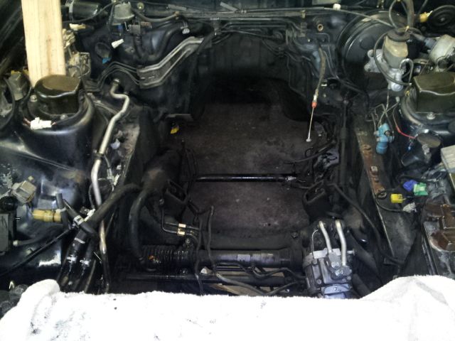

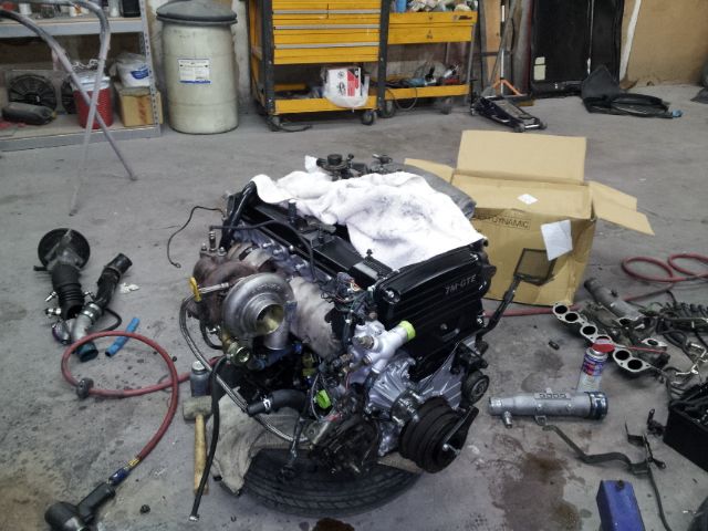

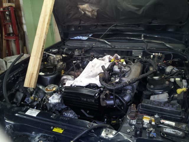

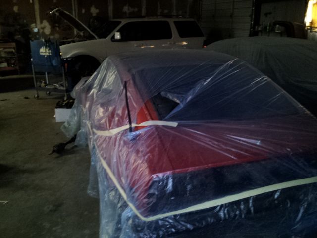

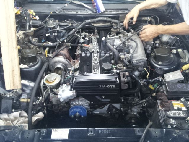

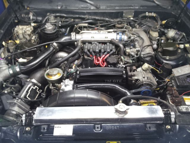

Well heres where it all started on Saturday
So I was surprised to see this in the shop a 280Z getting a repaint.
There she is ready to come out.
Empty abyss
Swapping parts over
Dropped in
All buttoned up and primed.
First start up didnt go so smooth the injectors were leaking but after that was sorted it fired right up. This is the impressive part for anyone who knows 7Ms. Hot Idle oil pressure was 10-15psi and at 2800rpms 75psi. so its pretty nuts.
http://smg.photobucket.com/user/Cobra281s/...9cbc04.mp4.html
Start up vid i took before i left sounds nice.
