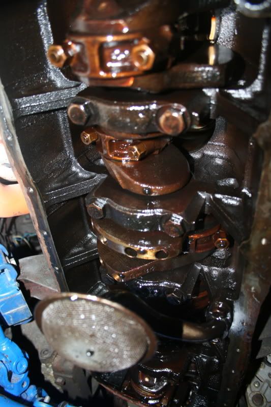

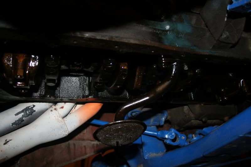

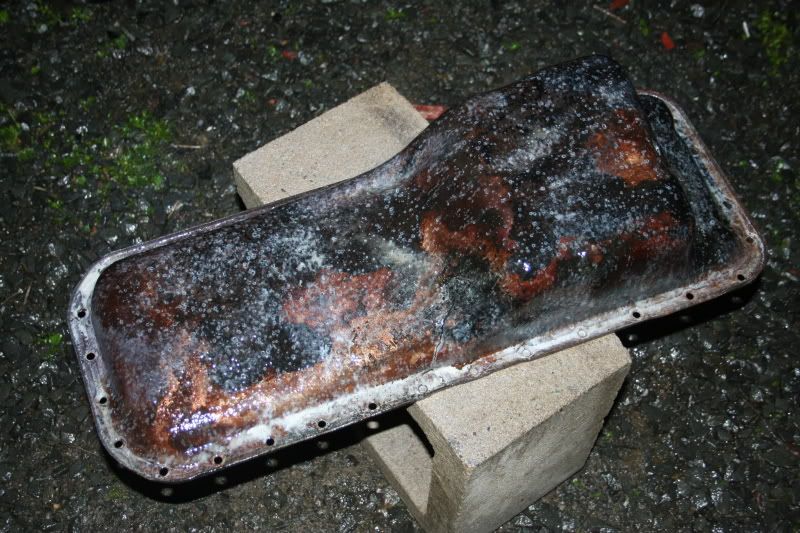

Under the knife again, but not because she's broke. Thankfully its my choosing.
I put enough miles on the seafoam treated oil so now its time to change it. While I'm at it, I'm removing the sump to de-rust and paint, replace the gasket, install a new valve cover gasket, and adjust the valve clearances (if needed).
As you can see in the background of the second pic the VHT didn't hold up too well on my headers. I'm thinking I just didn't prep the surface correctly, I don't think I'm running hot and lean.
The white pasty filth on the sump isn't because I had way too much fun removing it, that's just engine degreaser. Now here's your chance; I'm having a hard time deciding what color ceramic paint I'm going to use on the sump, so I'm holding a little social experiment so anyone with interest can "vote". Choices are either blue, orange, or I could put WAY too much effort into painting something no one will ever see and make it orange/black to match my valve cover. Straight black is just too boring. laugh.gif

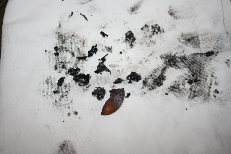

Unfortunately I also found some presents in the sump when I cleaned it out;
Now, if this were a helicopter, you better believe that the engine would be written off as compromised, but I'm hoping the standards for a 30 year old car are somewhat less strict. Not shown are a couple sort, hair sized slivers of metal. The largest piece you see there is interesting. Its about the size of a dime and is stamped "3M". I don't think there's any sort of space age duct tape wedged in there, but I'm completely dumbfounded as to what 3M product could have possibly been in my engine.
Everything seemed to be pretty non-magnetic, but metallic. I'll be checking for play while I'm down there, but hopefully I don't need new bearings. I'd like to put as little money as possible into this engine from now on, as I'm focusing on the turbo motor.

the smaller pieces wouldn't concern me much, because those are just excess casting imperfections. But the big piece would tongue.gif. Is that big piece just part of the pan gasket?
Well you know now that no one has ever touched the engine internals tongue.gif

QUOTE (AK-Z @ 34 minutes, 44 seconds ago)
that big piece says 3M on it, so it might be part of a cutting disc, or a peice of circular sand paper

QUOTE (TexasDemonZ @ 9 hours, 38 minutes ago)
Its possible, however it would certainly make for a very small disc (which I think I have seen in stores before). The side with the 3M label is smooth, but the other side has a cross hatch pattern imprinted on it, leaving me to believe that it used to be stuck to some sort of fabric at one point.
