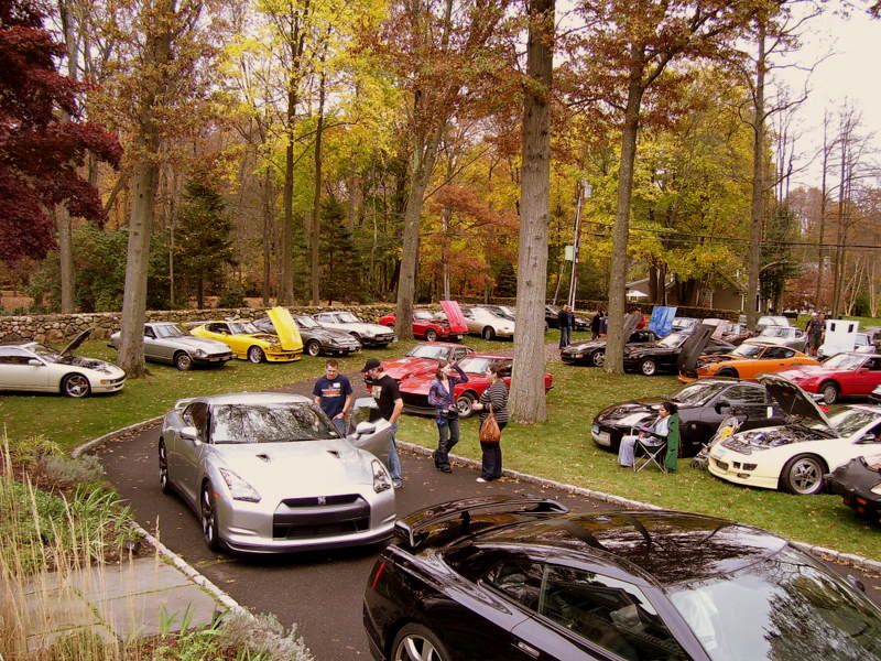

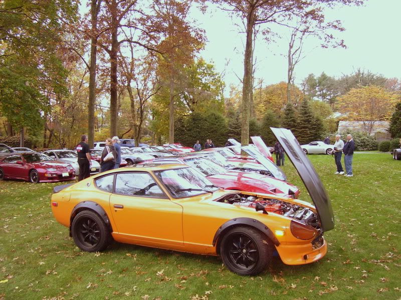

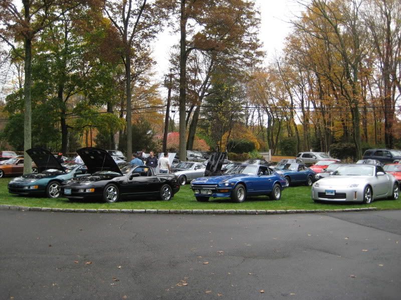

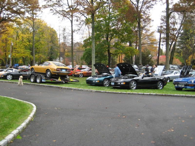

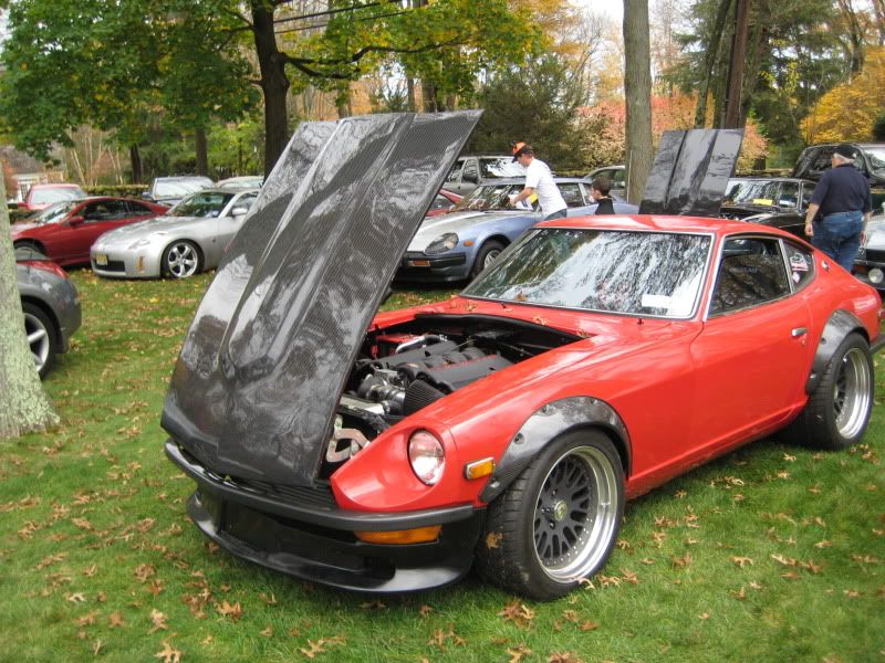

Pics from the last Z meet of the season
Posted: Nov 16 2009, 12:31 AM
twins on the red Z?
f**k your z is so sexy.
