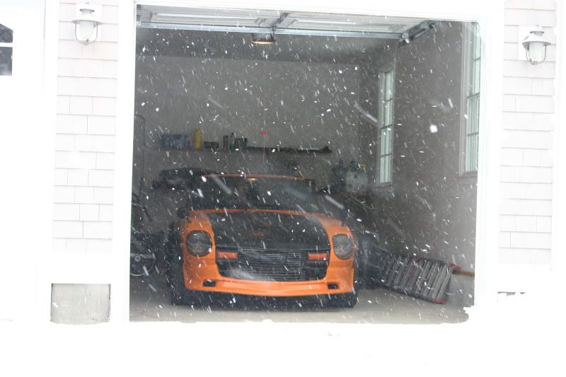

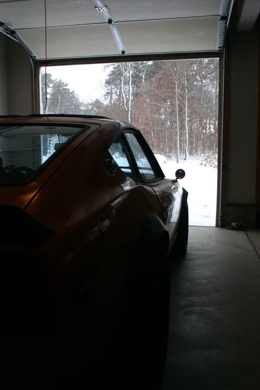

Posted: Dec 27 2009, 09:23 PM
The weather outside, being frightful...
The Z is going nowhere with this weather, physically. Although I have been tempted to take it out for some donuts in the snow, I've resisted the urge. The roads are hardly salted around here. Mechanically its not going through any progress either, because most of my tools are in temporary storage.

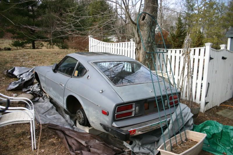

I also uncovered some photos that I forgot even existed. Looks like they were taken sometime December '07.

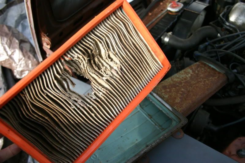

Rat bastards..
They ate through my old air filter... no wonder the car was hard to start that year.

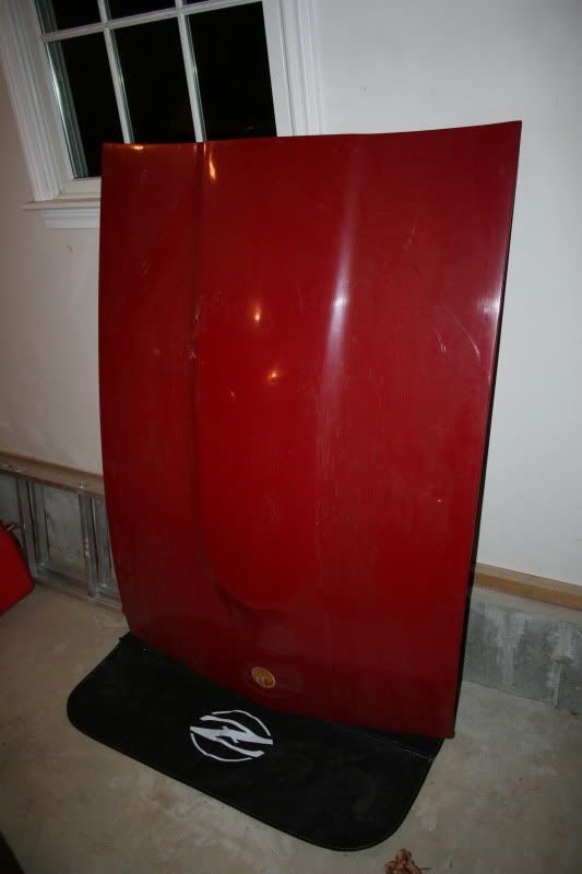

As for new stuff, my buddy gave me his spare hood for Christmas, its nearly flawless. My old one was bent in when my uncle backed into my car with his van a couple months ago. This new hood is from a 240z, so it doesn't have any vents. I'm not too fond of that from a functional point of view, but it should certainly look cleaner.

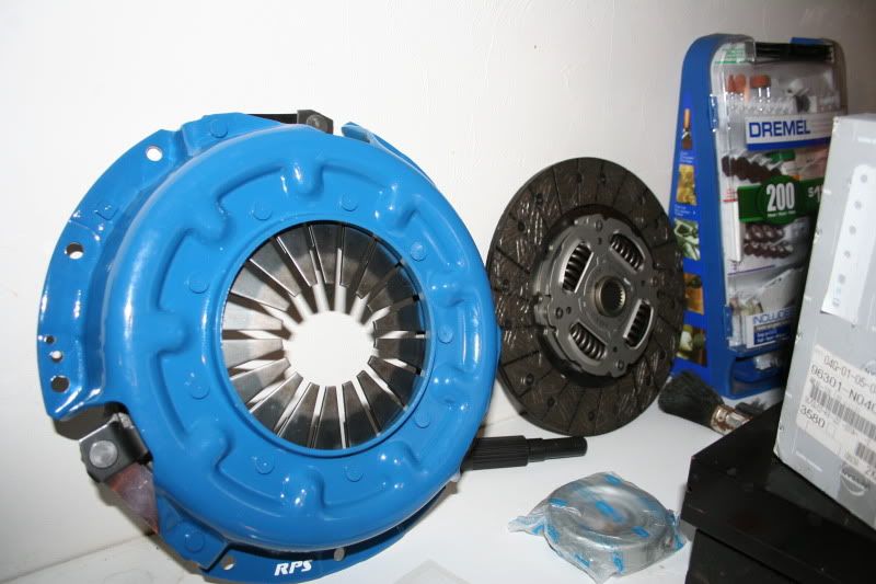

New clutch. Got it for a steal from one of the state club members who happens to be an RPS dealer. Still looking for a flywheel to pair it with, either aluminum or just simply resurfacing my current stock steel one.
My old seats are also gone. I salvaged these from a '73 240 for free. They are flawless, with no rips or imperfections besides a bit of surface rust on the metal parts. All I had to do was swap the rails. My old seats were covered in rips and cigarette burns from PO's, so I had put some baggy universal covers on them. These new full-vinyl seats are much more comfortable too. I know they're not racing seats... but dude, free seats in this condition? Awesome.
Once I get my tools back and start getting a little more time, work will continue. The garage at the new place is great, much more room to work.
Oh, and do you ever intend to switch your hood to a carbon fiber one?
This post has been edited by *DAN* on Dec 28 2009, 01:23 AM
Posted: Dec 29 2009, 06:15 AM
I have, but the free one was more readily available. Maybe someday.

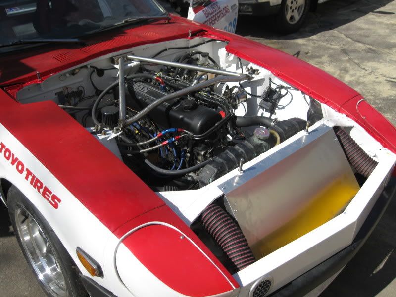

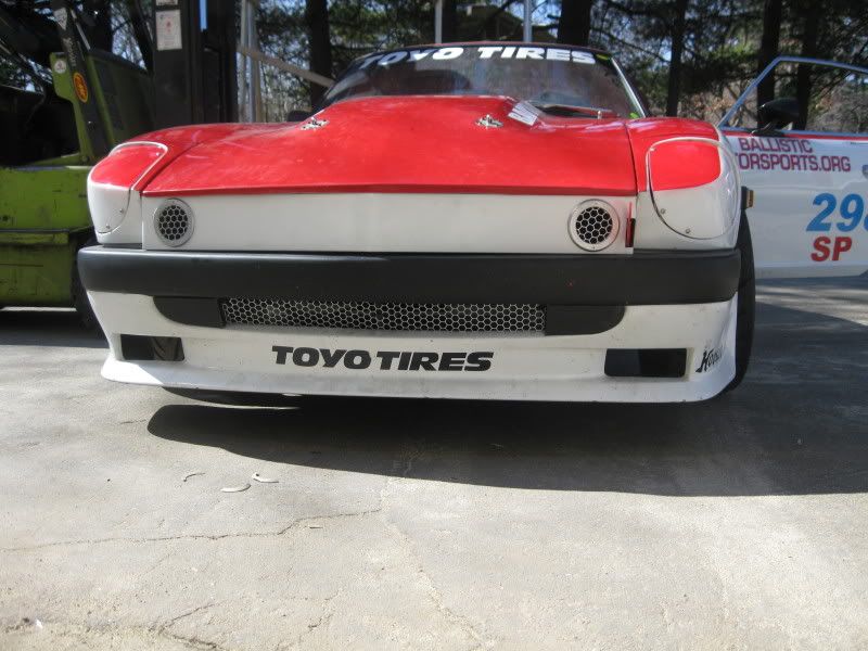

Rad block off: On the HBZ aero forum (or somehwere else on that site, can't remember it's been so long since I read the thread) there was a discussion on the actual minimum inlet size at the front of the car for the radiator, it's its significantly smaller (like, less than 50%) of the current opening. Ducting and extraction is nice, but not having *extra* air enter in the first place makes everything else easier.
Also, on the FG/CF debate, for the 1lb difference that MSA quotes, I can think of alot better things to spend the 400 bucks on tongue.gif
And it looks (to me) like other than going with a 280Z vented hood or Justin, the steel louvered hood @ MSA or the cowl induction setup are the only options...

*this* is what I was referring to about rad blockoff:
and some ducting on the inside:
Also, from the "Pics of your race car" thread on HBZ:
Hood was popped to see if that helped cooling. It didn't and strings showed that air goes in at the rear of the hood but goes out at the sides.
