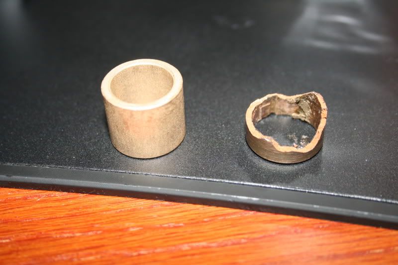

Got the plug out today at a local transmission shop. We torched it, pipe wrenched it and put candle wax down the threads. Finally we removed it with a big breaker bar while simultaneously hitting it with an air hammer. Those guys were great, and they didn't even charge me for it. I'll have to drop off a case of beer or something for them some time. New plugs ordered from Nissan, should be here Saturday.
[ Post merged on Mar 4 2010, 04:42 PM ]
The pilot bushing I just pulled is on the right... It was visibly pretty far gone even before I popped it out with the grease/socket method.
