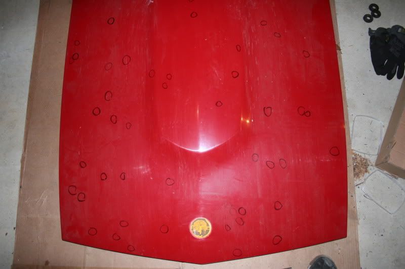

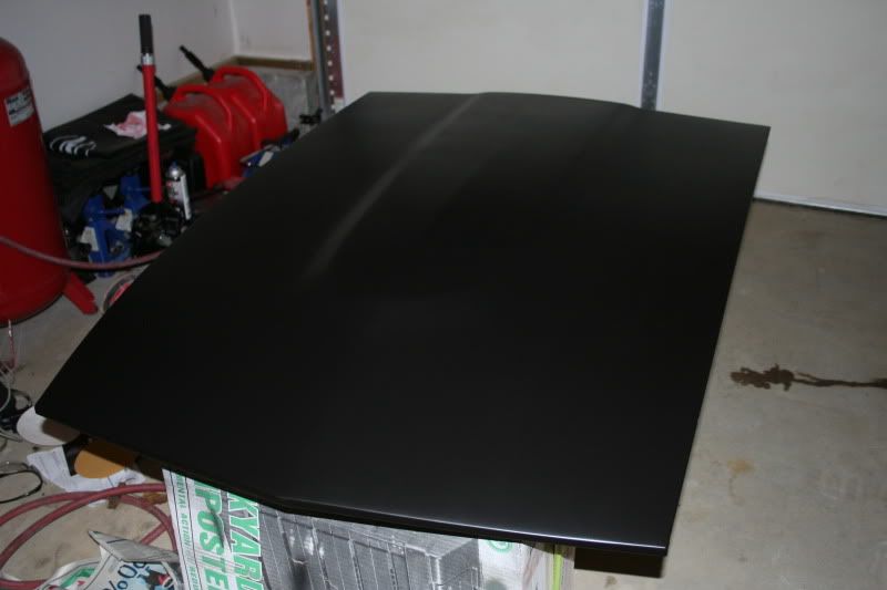

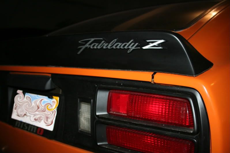

New stuff. Fairlady emblem is on.
"New" hood. Got this for free from my friend, used to be on his Z before rust claimed the body. Hood is almost flawless, except it sat under a very large oak tree that frequently dropped acorns in it. There were a total of 84-90 dents I had to fix.

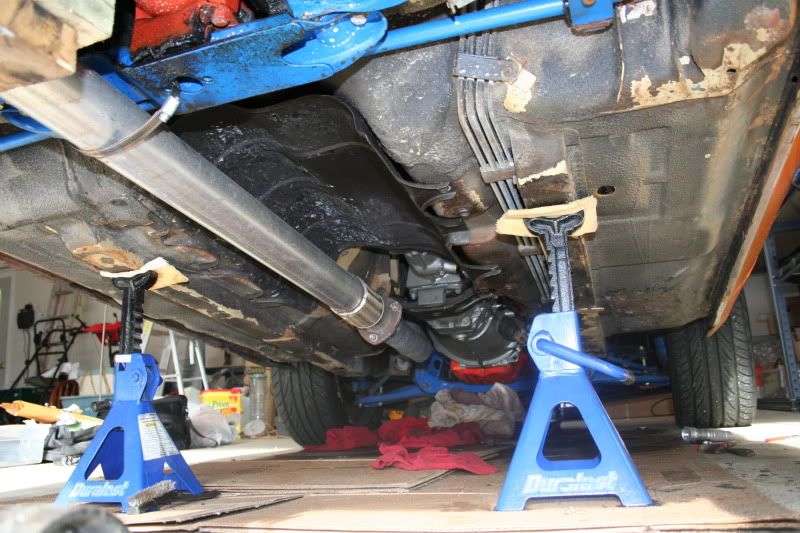

Annual rust harvest.
And taking things apart...
