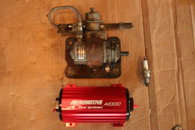

Took the plunge. Well, half of it. Have to wait until next month before I fully convert the fuel system to AN. Right now its a bit beyond the budget once priced out with all the fittings and SS braided hose. Going to see how long this stock gas tank will last as well before I get the fuel cell. I remembered I had a POR-15 tank lining kit so I blasted it out and sealed it. Hopefully it lasts, but I'm running a few filters just in case anything happens.
So, the damage so far is one A1000 pump and A1000-6 RRFPR, two steel mesh filters (100 and 40 micron), and all the associated fittings to plumb them into the system which basically consists of barb and pipe thread adapters. It should hold just fine for now. The A1000 is a bit overboard, but should offer a decent amount of future buildability... and excess noise. I'll just have to mount it really well with rubber isolators.

I honestly thought when I ordered it that it would be closer to stock size and not this freakin' huge. Main reason I got it though was for the reliability and the -10 AN fittings on each end which should lend well to the rest of the fuel system setup when its done. Heard nothing but bad things about Walbros, MSD and Bosch 044s (bosch being the most reliable out of that bunch, but the accounts of failure I read were scary), and heard nothing bad about the Aeromotive besides excessive operational noise. I'll have to figure out a good mounting setup with isolaters, and will probably end up getting the Aeromotive fuel pump speed control to keep it quiet unless the car is going up in the RPM range.
The only thing that annoys me is that this pump is SO CLOSE to being able to mount to the stock FP brackets, but the holes are just slightly offset enough so it won't fit.

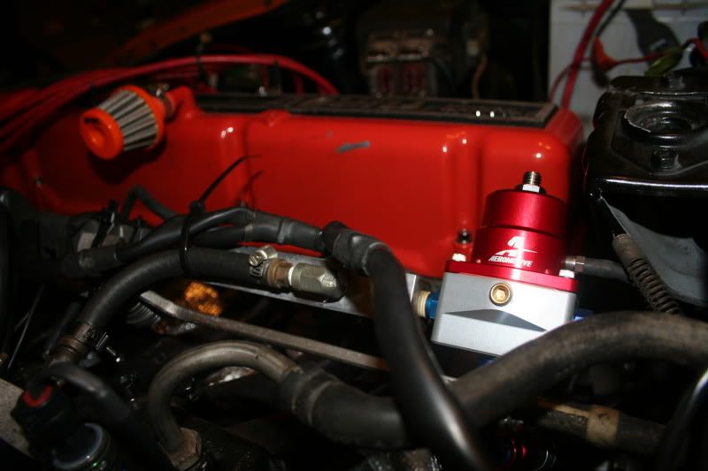

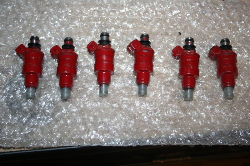

The FPR is already attached to my rail and it ran great this weekend while I drove down to an awesome JDM cars and food meet at my buddies house. Provided good fuel pressure the whole way, and it was sweet to be able to adjust it. Also pictured are a set of 6 460cc Rx7 injectors that I got for $100. They're waiting for the new o-ring style fuel rail. The Z will have to be tuned shortly after since they push almost twice the fuel as the ones currently on my engine.

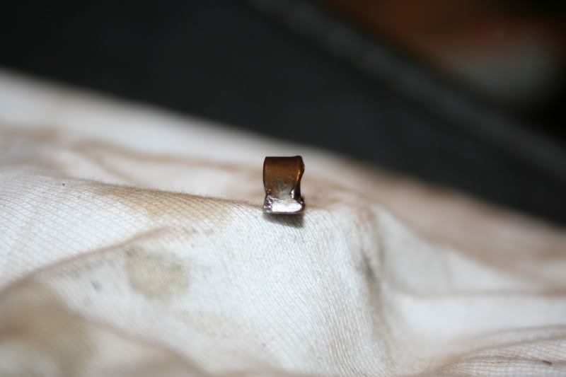

Burning oil cause a valve cover bolt failed at the threads, consuming coolant, clunking sound getting worse and persisting through hot and cold engine temps. Today is a wonderful day.
Posted: Apr 26 2010, 12:55 PM
QUOTE (Oddmanout84 @ 12 minutes, 20 seconds ago)
Is it what I think it is?
Posted: Apr 26 2010, 12:57 PM
Dunno. We'll find out. Might be pulling the head tonight.
Best case scenario I replace the headgasket and head bolts with ARP studs. Yes, best case. Besides nothing, but I know better than to assume that first off instead of the worst possible.

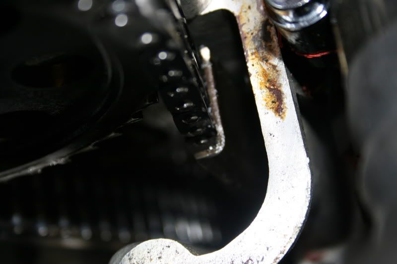

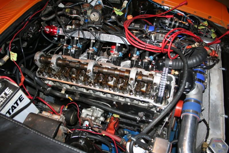

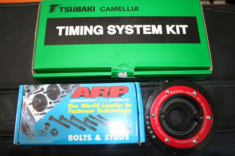

Update: Not ABSOLUTELY positive, but I believe I found the source of the excessive ka-lunking noise that I had been hearing. The timing chain has worn through the anti-friction material on the left (downward running) side of the engine all the way to the metal. One of the guys at this weekend's meet remarked how it sounded like timing chain noise, he's probably right. Regardless, I need a new timing chain guide which will probably result in buying a whole damn new timing kit. The price isn't the worst of it, the fact that I have to figure out how to replace it without removing the whole engine is the challenge.
Plugs pulled, #2 is cleaner as usual, damn it. #6 is the dirtiest, but looks like rich AFR deposits rather than oil, which is to be expected since I have the engine running much richer under boost to compensate since I don't have meth or anything.
[ Post merged on Apr 26 2010, 07:25 PM ]
Begin head removal.
Its hard to see from the picture, but the timing chain guide is worn through the friction material to the metal.

Its just a pain, that's why I'm unhappy about it. There's things I'd rather spend money on than a timing chain set and head gasket for a motor which only has 5000 miles on it. The guides should not be going that quick. I'm removing all the accessories, intake, exhaust, everything and the rad is coming out because it could use a drain and flush anyway. I'll probably end up getting a harmonic damper to replace the crank pulley too while I'm at it.

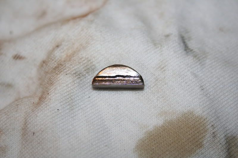

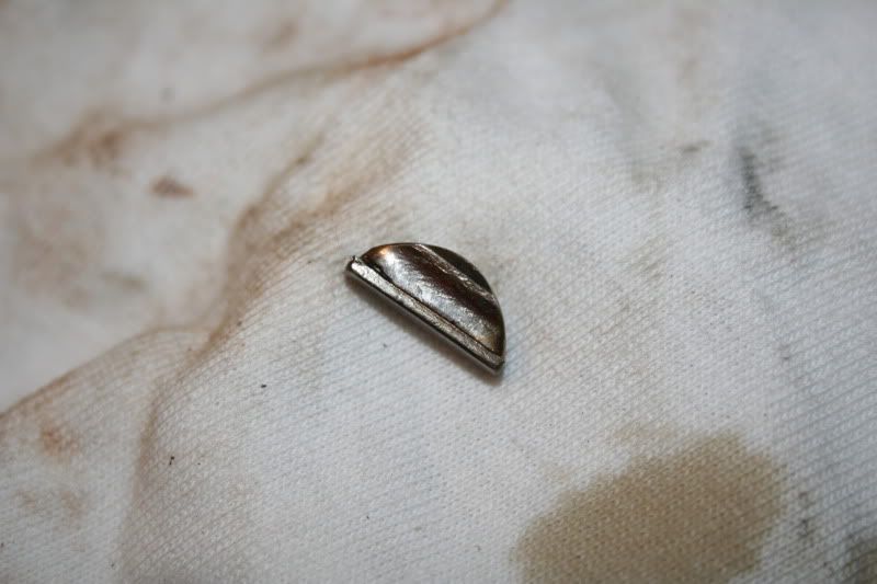

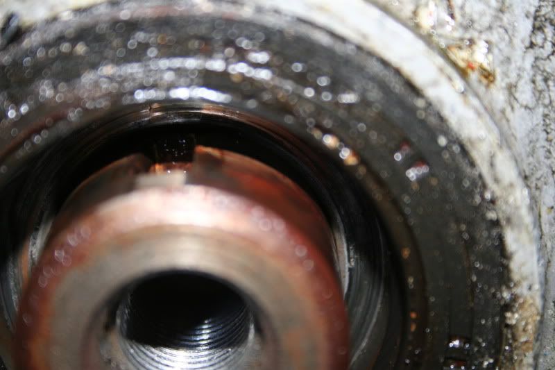

Take that hanz woodruff key!
Posted: Apr 29 2010, 04:18 AM
QUOTE (StraightAwayZ @ Yesterday, 5:29 PM)
Yeah... metal to metal is never a good thing. The key hole on the crank snout was widened in the process. All cause my pulley bolt decided to back off 5mm.

Those dampners aint cheap! Now thats what im talking about. Seeeeee, it wasnt so bad tongue.gif
Posted: May 16 2010, 06:03 PM
$200 for the SFI spec damper was still a lot, even when compared to the $600 ATI damper.

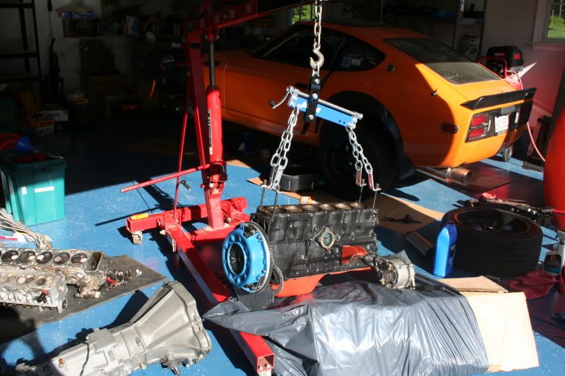

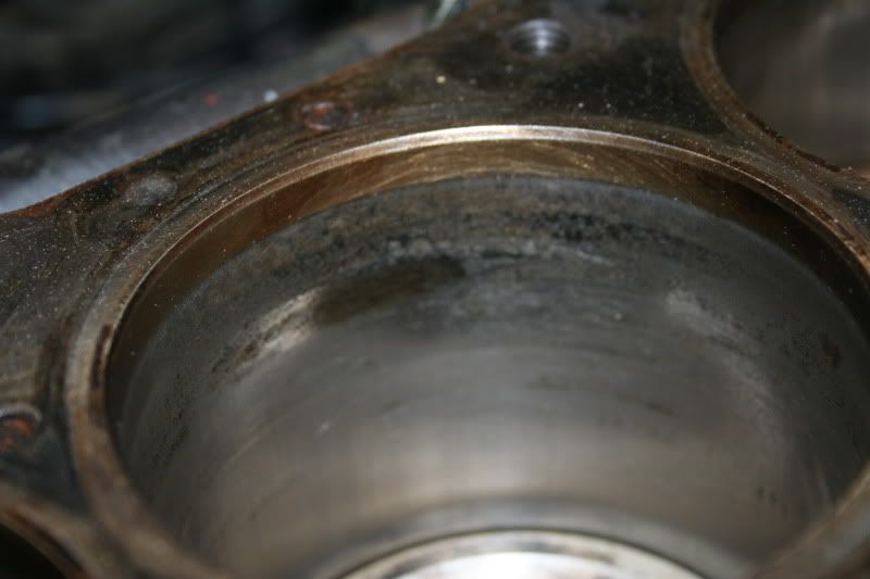

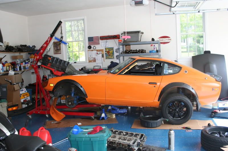

Yes, it is bad. The whole crank is coming out, as well as the pistons and rods. Crank needs to be magnaflux inspected, but I might as well just throw in one of my spare cranks that are good. Damn near full rebuild and reboring of the block coming up depending on what I find. And that may mean new pistons too. dry.gif
Posted: May 24 2010, 02:10 PM
The one man engine pulling party was a success. Very easy, surprisingly.
Couple of the cylinder bores are particularly nasty. It looks like some water got into the chambers while the engine sat in my buddies garage for 4 years and pooled around the oil rings and compression rings. Couldn't be seen until I pulled the head the other week. So the block is going over to the local machine shop for a .020 overbore at the same time the crank gets inspected. Yes, already have matching pistons in my possession, although not right now actually. Just sent them out.
